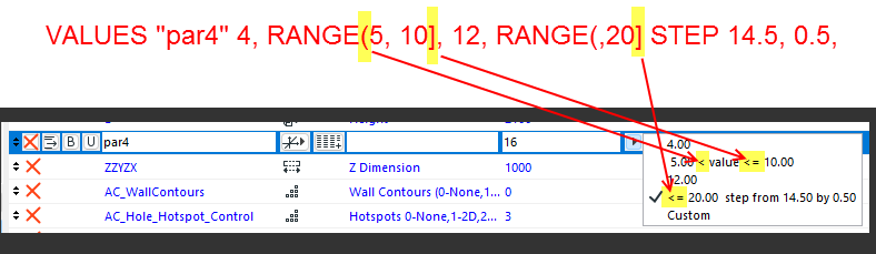

You have used the brackets yourself in your example
( will just be less than <
[ will be less than or equal to <=
