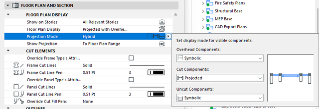

Hi everyone I'm trying to overwrite a custom curtain wall panel I've created, as when I visualize it in plan view I'm not seeing the correct shape of the panel.
I'm currently using Archicad 23.

I ran into the same problem, don't think it can be done.
I use the projected display under the curtain wall's Floor Plan and Section settings, and code the custom panel to show a different model when GLOB_VIEW_TYPE = 2 (plan view).
