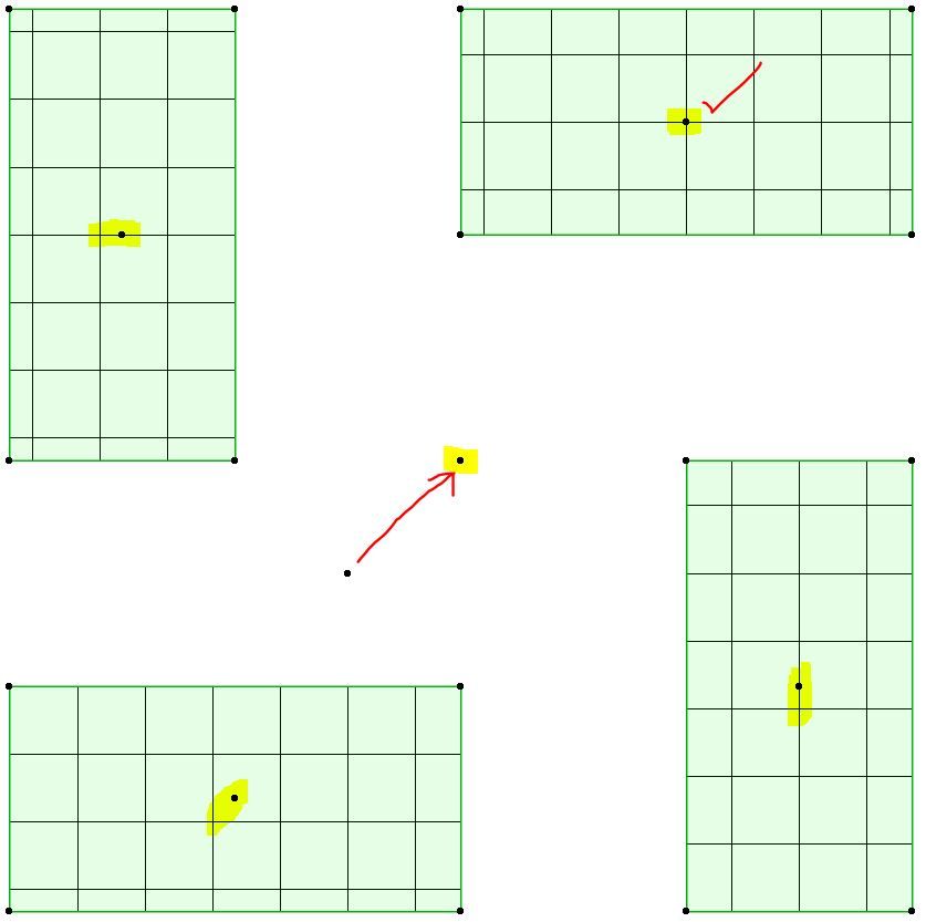

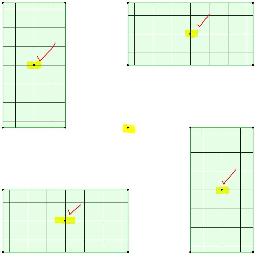

I've reached a dead-end and can't work this out.  It's a first for me using the POLY2_B{2} command and I'm trying to set the fill origin for a fill to the center of the fill.  I've got the j4(8) code in the frame fill it responds to changes in the origin variables.
However, before drawing the fill several cursor movements are made to get to that point.  Now when the fill is drawn the origin is all over the place.  I've included a test object code below (no parameters required) which shows this.  There's a loop that draws the fill, rotates 90° and draws the fill again.  Drawing it 4 times.  The origin is in the center and everything is good.
But then a simple ADD2 1,1 is added before the loop. Now the fill's origins are off by 200mm for each iteration of the loop in one or both the x & y directions.  If I throw in an angle for the fill origin it gets even more confusing.  I had assumed the fill origin x / y coordinates would be based off the cursor position, but that's not the case.  Does anyone know what's going on here?  Or do I need to draw the fills without any movement commands?  Thanks,

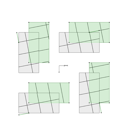

don't confuse what you think you see with what you should look at.
if you explode the object (Ctrl+=) then you see the origin is off by 1mx1m.(i added in a slight rotation and a larger scaled fill to pick this up)
because the temp origin is being calculated then

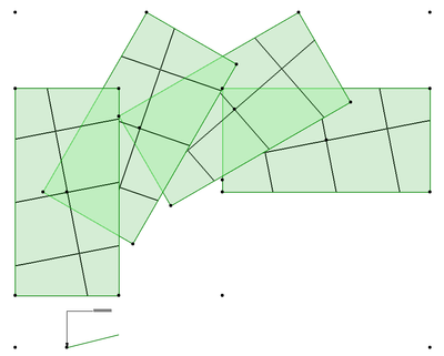

That made me think of Obi-Wan - "Your eyes deceive you. Don't trust them".  Exploding the object to find the actual origin is a nice trick I hadn't thought of.
Attached is an image of the exploded fills from the object I'm working on.  It's one fill command that sits within two loops.  Now that I know where the actual origins are, I'm considering if I should spend the time to work out how to control these fills.  Or just change the script to draw some lines over the top and make it look like the fill I need.
Thanks again for the help.
