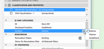

I'm working on a mark for a door that behaves differently if the door is inside or outside.
I've seen that you can display the parameter interior/exterior in a label, but when opening the GDL of the label, the corresponding macro is too complicated for me as it displays all the properties, so I can't get this one piece of information.
How can I retrieve the interior/exterior information simply in GDL?

Thanks Barry,
I wasn't talking about the interior/exterior face of the door, but the parameter that you manually check and that is exported in IFC (Position Category for Ifc).
Archicad 27 - GDL - PYTHON
Ah, you mean this setting.
It is not an actual object parameter.
I think you have to get that with a REQUEST in GDL.
What label is it you were using?
I might be able to help track it down for you.
Yes, it's this one!
I found the info in the label " Classification and Property Label"

It works well, thank you!
I want to use this request in order to have different representation of the door marker when the door is inside or outside the building
I have an error message when saving the GDL object, but It works.
