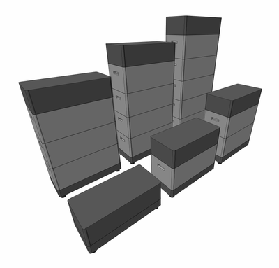

I'm building a parametric component for a modular battery storage unit. Everything works in terms of basic geometry creation, but I want to finish the component with some additional details - recessed handles and grooves.
This is what the 'dumb' component looks like:
This is the parametric one:
I need to undertake a subtraction to create the grooves and handles. I've created groups, and looked up the SUBGROUP syntax, but I'm getting an error.

I've checked the syntax, but when I run the Check Script function, I get this error:
Group name or group type expression required at line 249 in the 3D script of file BYD Battery Box LVS.gsm.
I'm not sure what I'm doing wrong - any ideas?

There are lots of subtleties in terms of where you use single quotes, where you can use double quotes, where you shouldn't use quotes, and the order in which you place commands including KILLGROUP.
The 3d elements and parameters of the object are complete:
I have the 2d view to script.
This is my first parametric object which can create alternative configurations of something.

Single quotes ' or double quotes " - there is no real difference when creating a group name so long as they are used in pairs.
When you create a group the name must be in quotes i.e. GROUP "group_1".
If you place that group the name must also be in quotes.
Basically if it has quotes, every time you use that name it must be in quotes.
However, when you create a new group by merging 2 groups - i.e. newgroup = ADDGROUP("group_1", "group_2"), then that new group does not have quotes.
Now when ever you use that new group name, you do not need to use quotes.
It is a little confusing I agree, but is just the way GDL works.
