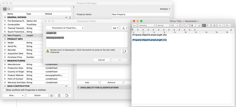

Dear support-team
Is there a way to get more GDL-properties into the property-manager in Archicad? I tried it with changing the property in a txt-editor, but Archicad don't accept that.
Do you have another idea or is this part of Archicad closed?
Thank you.
Archicad / Archicad 28 / 29 INT/ CHE/ FRA
Windows 11
2 Replies 2
To my knowledge at least in version 24 this is not possible outside of what is currently available
kuvbur
I wrote small add-on to sync GDL parameters and property, but it russian. Feel free to fork and use - https://github.com/kuvbur/AddOn_SomeStuff
