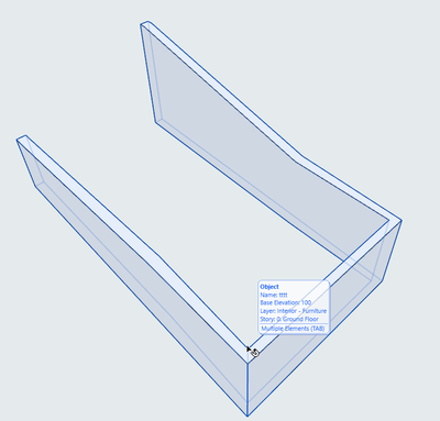

This is a question about TUBEA.
It was done with TUBEA.
As the height changes, the thickness changes.
I want the thickness to be the same.
Is it possible?
The thickness went from 150mm to 100mm and back to 150mm.
TUBEA 2, 10, 1 + 2 + 16 + 32,
        0  , HBottom, 0,
        um_ThkWall, HBottom, 0,
Wid  , -100, 0,
Wid  ,   -0.1, 0,
Wid  ,    0, 0,
Wid  ,  um_Length_Start , um_Height_Land,
Wid  ,  um_Length_Start+WidL, um_Height_Land,
-Wid ,  um_Length_Start+WidL, um_Height_Land,
-Wid ,  um_Length_Start , um_Height_Land,
-Wid ,  um_Length_Start-um_Length_End, ZZYZX,
-Wid ,  um_Length_Start-um_Length_End-0.1, ZZYZX,
-Wid ,  um_Length_Start-100, ZZYZX

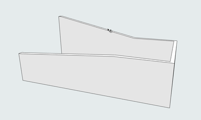

Pertti Paasky
Sweepgroup produces good results.
d1=.1
d2=.1
x1=0
y1=0
z1=.5
x2=1
y2=0
z2=.6
x3=1
y3=1
z3=.7
x4=0
y4=1
z4=.8
group "TUBE2"
pen 1
material 1
gosub "TUBE"
endgroup
g_expr="TUBE2"
x=0
y=0
z=-1
edgeColor=1
materialId=1
materialColor=1
method=1
placegroup SWEEPGROUP{3} (g_expr, x, y, z, edgeColor, materialId, materialColor, method)

Pertti Paasky
Maybe You can use TUBE and cut it with a TubeA by solid element operations.
Tube keeps it´s profile the same.
The tube path  should be flat.
The TubeA should be thick enough so that the minimum thickness is present everywhere.
The code can be like this:
Group  "TubeA"
endgroup
Group "Tube"
endgroup
placegroup isectgroup ("Tube", "TubeA")
killgroup "Tube"
killgroup "TubeA"

LeeJaeYoung
I learned a new way with your help. thank you ^^
