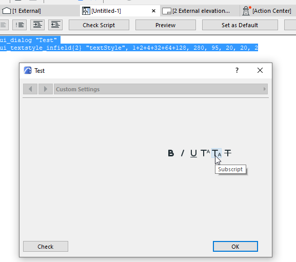

Hi everyone,
With "textStyle" as a integer type parameter and within the UI script :
ui_dialog "Test"
ui_textstyle_infield{2} "textStyle", 1+2+4+32+64+128, 280, 95, 20, 20, 2

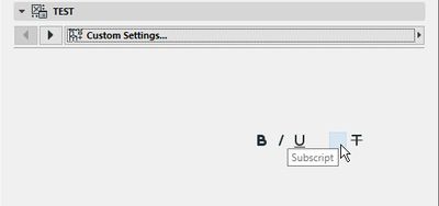

On the Selection Settings Dialog, there's no icon for superscript and subscript. The placeholders, the tooltips, the functions are there (you can select it and it set the value correctly) but not the icons.
This happens in Archicad 28 (with the latest update ... not sure if it happens on earlier versions as well) and also the Tech. Preview 29. Can anyone confirm if this is a bug, or it's me?

I can confirm this does not work in 28.
Works fine in 25.

Kornel Beleznai
Hi there,
Thank you for raising this issue and reaching out about it.
After checking with the development team, I can confirm that this behavior is indeed a defect that has been registered as DEF-23745 in our system.
We haven't received other reports of this previously, so it appears to be a less common workflow. However, if it receives additional user attention, Product Management will review it for potential prioritization.
Thanks again for bringing it to our attention.
