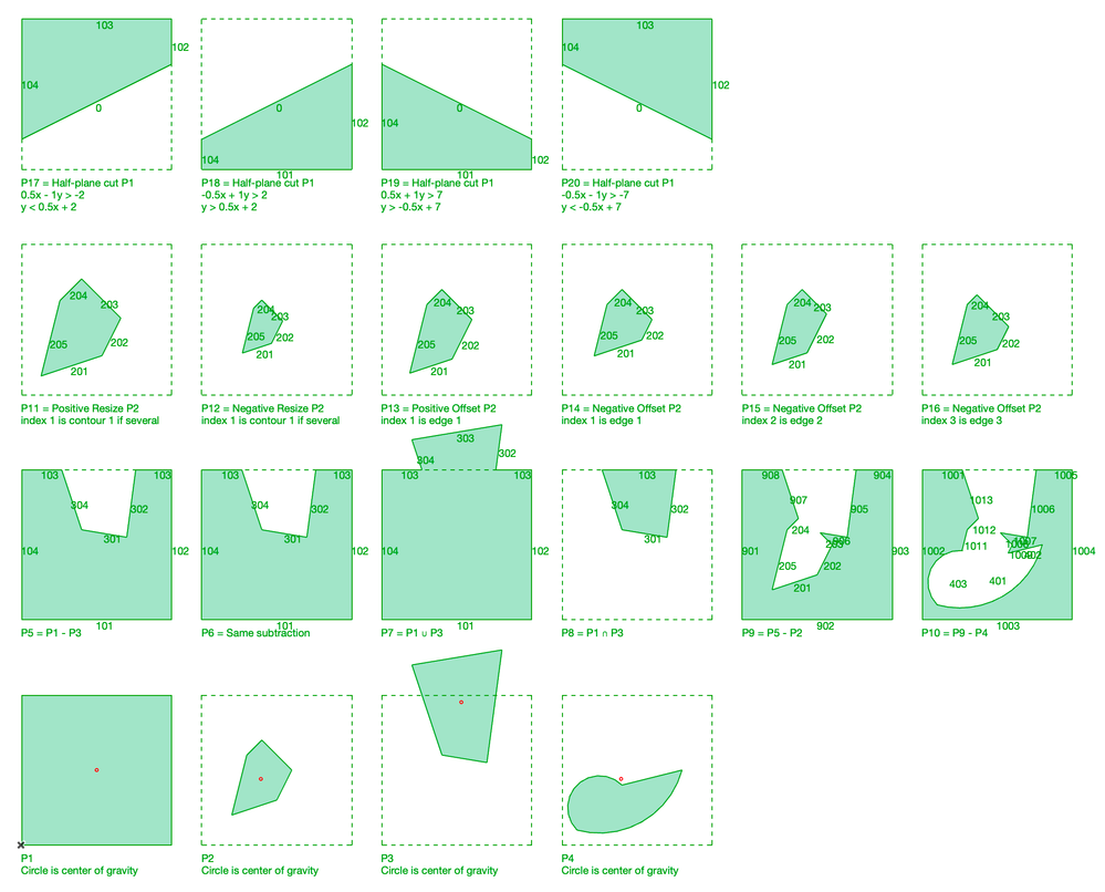

Hello @yongler ,
Here's a .gsm I made with many examples.
The file was based on the example in the LibDev Toolkit, I believe it was the version 19 so maybe the newer ones have more than there was in that file. Anyway, I cleaned up my file today and tried to add meaningful comments and variable names so I hopefully it helps.
Version is 24.

Thank you very much. This has helped me, as I need to delve deeper into my studies and research. Thanks again.
@MF BIM excellent examples, thank you too!
I tried to dig into this topic many times, but I couldn't find clear and simple examples.
