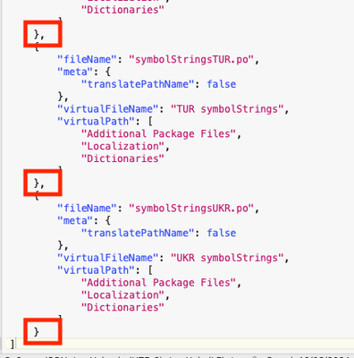

I found the solution,
After each entry there is a comma, but on the last one there should not be a komma
Also be aware that it won't work when there are 2 identically named objects (even in different folders)
