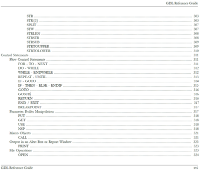

is there a DEF in gdl? I mean defining functions.
I've been hearing time and time that GDL is based of BASIC. I know that it doesn't have everything that BASIC has but I'm also a bit weirded out that GDL doesn't have basic programming structure like functions. I haven't seen any mention of defining functions in the GDL resource. They do however have mentioned functions to basic stuff but not me creating one.
Is there anyway to create functions? seems like macros are the closest to functions?
1 Solution
Use macros if you want to access them from multiple objects.
Use sub-routines if just within the one object.
Go to post

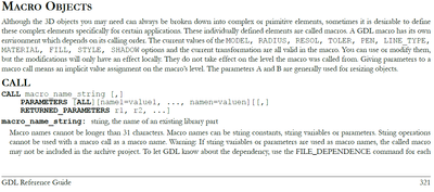

MetalFingerz
@Barry Kelly,
I'm just rebounding on your reply about macros as I would like to know if macros should be categorized as "macro" ? I usually keep the same subtype as the actual object and make it not placeable but is it bad practice ? I do so because the macro seems to lose some of the default parameters of specific subtypes while doing so...
What you are doing is fine.
A macro can be any object, even a placeable one.
But if you don't want it to show in the library object dialogue, make it not placeable as you have done.
The sub-type does affect the default parameters.
So yes, just choose the sub-type that suits you best - the same sub-type as the CALLing object is ideal as you have discovered.
