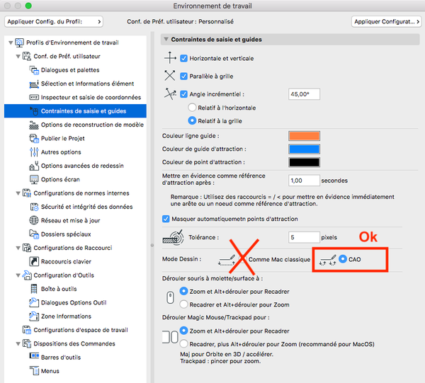

I updated my macOS to Sequoia and now when I'm drawing a wall, a slab, fills, polylines etc I have to hold the mouse button when drawing the first segment. I have a colleague who have the same problem on macOS Sonoma.
We both work on Archicad 26 because some of the computers at are office are older and can't handle newer OS with the consequences that we can't install later versions of Archicad.

Check this setting
