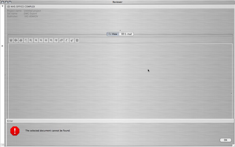

mac - using safari. i get the 'graphisoft project reviewer' page no problem (which acts as a java detection page i think?) . . . but then no content to review. is that right?
~/archiben
b e n _ f r o s t
__archiben
hang on! spoke too soon . . . i left it open in the background....
it took a while, but the trust certificate popped up and then a while later i got the reviewer screen. and that's where it stopped:
i got the following error message stating that the content could not be found. as i said, intel mac/osx/safari is what i'm using. seems as though if it can get the reviewer up and display the name of the file you uploaded it's likely to be permissions as you suspect . . .

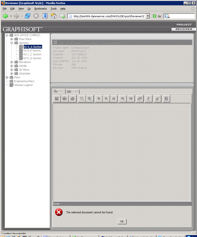

Got it fine, but files not accessible.
IE6
Djordje
ArchiCAD since 4.55 ... 1995
HP Omen
Gorazd
Same here. Document can not be found. I am using Win XP Home and Firefox (Slovenian version).

i don't know if you're still interested in this, but i figured it out.
the source of the error you're getting is from the presence of spaces and other URI unfriendly characters in the filenames of the DWF's in the project folder. you have to strip these out of the filenames, and also out of the href entries in the Contents.xml folder. i wrote a php script to do both, in case anyone is interested.
as this is a relatively egregious error, i have to wonder if project reviewer was even tested before 10 was released, since one of the nice features (and isn't it a default?) in 10 is the prefixes on layouts and subset names. as these are automatically carried over into publisher from layout book, the spaces come too, in addition to anything in the layount name.
edit: changed "title" to "href"
