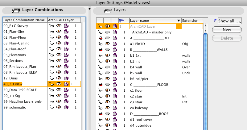

how do you hide elements in a given view?
say, i have a mesh that i don't want to see in plan view but want to be visible in 3D view. when i change the layer settings to hide it, the mesh disappears in 3D as well. it says in the reference guide that "the settings of any particular layer can be different in the layout book and in model views." does this mean i cannot control visibility in the default views?
Rod Jurich
Set 2 different layer combinations, 1 for your plan view and 1 for what you want to show in 3D.
