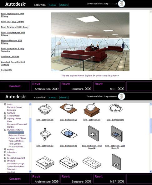

can anyone point me to where i can find an archicad libary if such exists? i checked out the graphisoft site first thing but can't find anything. googling just led me back to the archicad talk forum from where i found the announcement that an ACE library is available for download but only for macs. the depository, which is a great idea does not really serve my purpose. i was thinking more of a comprehensive library like that at revit (see attached).
Greenfin, the comprehensive Archicad 11 library is supposed to be installed with your default installation of Archicad. Is it loaded? Check your library manager.
Use the Object tool (Double-click Chair icon) to find objects and modify their parameters. (Doors and windows, also in the library, are accessed by their respective tools. Check the help file too.
If you want more, search this forum and Google for GDL objects.

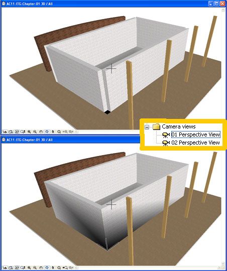

the attached is a screenshot of two perspective views of the same project file (chapter 1 of basic e-guide). in the picture above notice that the walls are not connected but below they are. (the inset _from the navigator view map_ shows the two views.) why is this?
