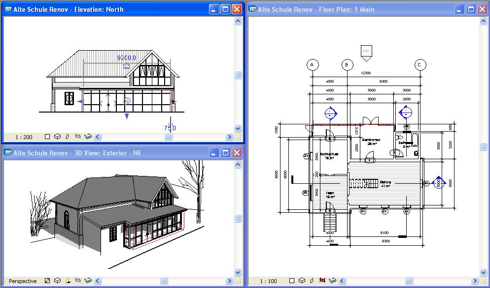

In Revit when I select an object/element in one view and want to see it in another view, I just click on the new view and see my object highlighted in that view. This doesn't seem to be the case in ArchiCAD_at least not the way I've been trying to do it. Is there something special I need to do like stand on my head and 'caps lock' click with my left big toe? 😉

thanks but i don't want to isolate the object (which clicking F5 seems to do) but see it in the context of another view.
here's a screenshot of 3 views in revit. in plan view, i've selected (highlighted in red) the curtain wall on the north side of the building. as you can see (or not?... too small?) it is also highlighted in the other views. can you do the same in archicad?

greenfin,
Highlighting an element in one elevation will not highlight it in another elevation, although any changes you make will be reflected in all the other elevations when they are updated (ie when you next open/select one).
Only elements modified in the 3D window will automatically update in realtime on to the floor plan (strangely not the opposite!?). None of the other views are linked in realtime. They all require some form of updating to see any changes.
So the answer is no, not really!

that's good to know so i don't waste my time figuring out a way to do it but i'm really quite surprised, i had expected archicad to be able to do anything revit can and more.
