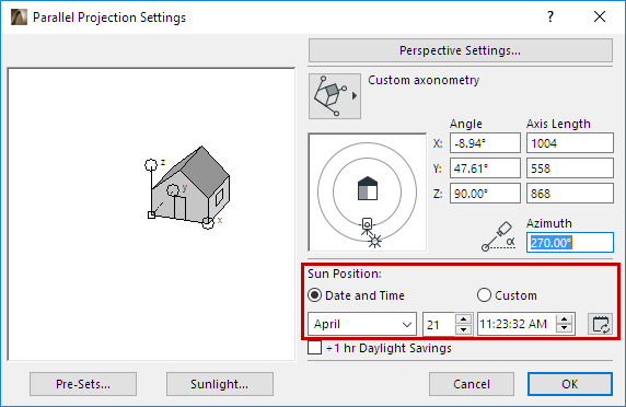

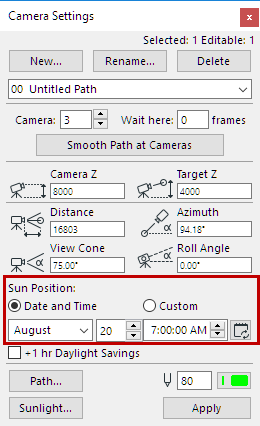

Control Sun Position by Date and Time
Set the Date and Time for Cameras and in the 3D Projection Settings directly, and save it to views.

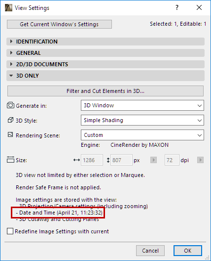

Previously, setting the date and time in the Sun Settings would only update the Sun Altitude and Azimuth, without storing the corresponding date and time settings. Now, the Date and Time settings are stored and remembered. If you update Project Location, the sun will automatically update to show the correct sun position for that date and time.
  • Saved 3D views indicate the stored date and time or the custom sun position
  • Sun Settings dialog has been greatly simplified and renamed to Sunlight Settings

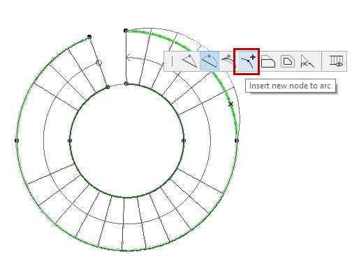

New Pet Palette Command for Editing Curved Polyline/Edges
Use the Insert New Node to Arc command from the pet palette.

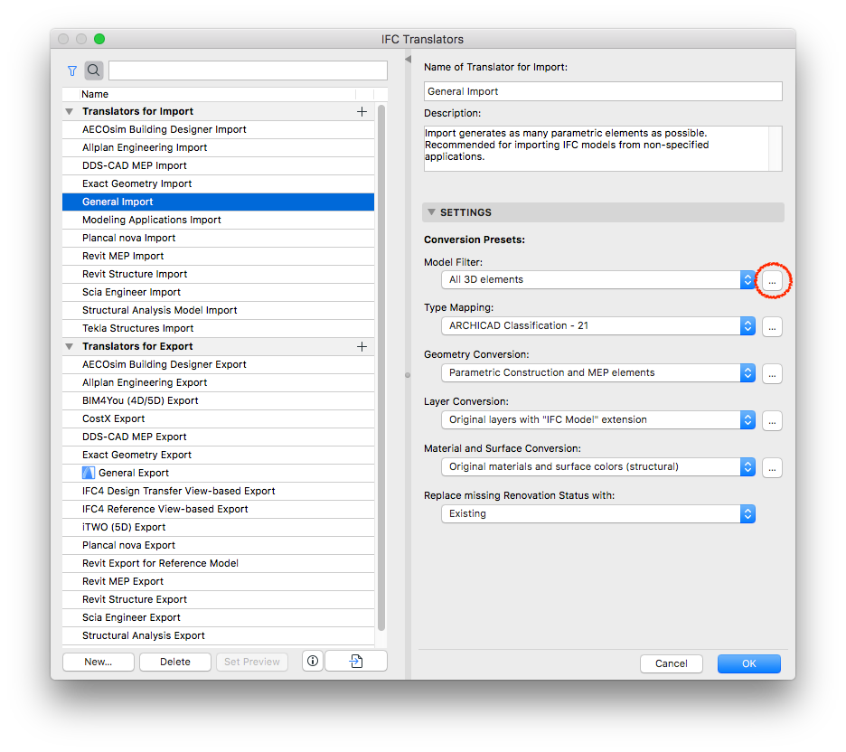

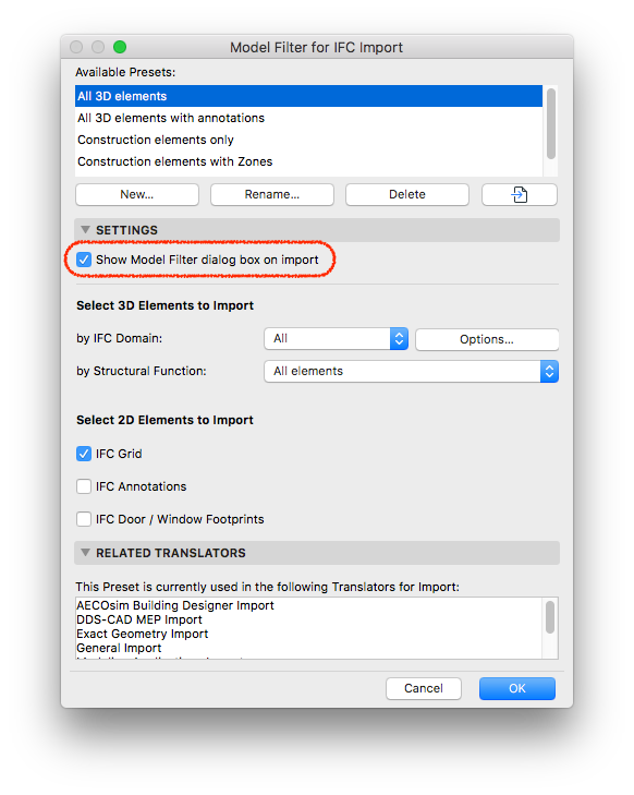

Filter Model at Import turned off by default
When Hotlinking, Merging or Opening an IFC file, you must select an IFC Translator for Import, which controls the conversion process. Every IFC Translator for Import has a filtering component (see Model Filter for IFC Import), which defines which elements of the IFC model should be placed in ARCHICAD (and which should be skipped). Each Translator for Import also contains another, secondary Model Filter function. This dialog (Model Filter for Import) allows you to further fine-tune the set of imported IFC elements, based on more specific element categories - e.g. type, story, owner. However, this secondary Model Filter for Import dialog does not appear by default. To use this feature, turn it on in IFC Translator Settings:
    1. Go to File > Interoperability > IFC > IFC Translators.
    2. Select a Translator for Import.
    3. Under Settings, open Model Filter
    4. Settings.Check the Show Model Filter dialog box on import box.

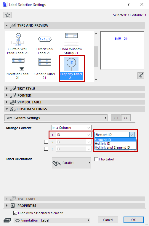

  • The former Identification and Property Label is now called Property Label. The ID display options for this Label (as well as for Zone Stamps) have been changed to:
    • Element ID (formerly Compact Element ID)
    • Hotlink ID (formerly Master ID)
    • Hotlink and Element ID (formerly Full Element ID)

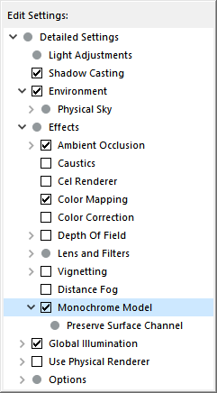

Renamed and Improved CineRender Effect
The Monochrome Model (formerly White Model) lets you choose any custom color, and adjust its surface characteristics (e.g. transparency, reflectance)
