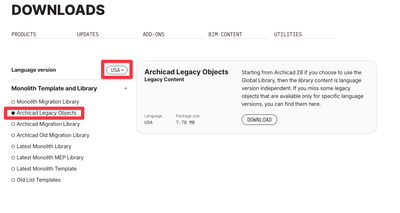

If you need the “Archicad Legacy Objects” for a different language version (for example, you installed Archicad INT but require the USA Legacy Library), you can download it from Graphisoft’s official downloads page. Once downloaded, add the LCF file to your project via the Library Manager.
