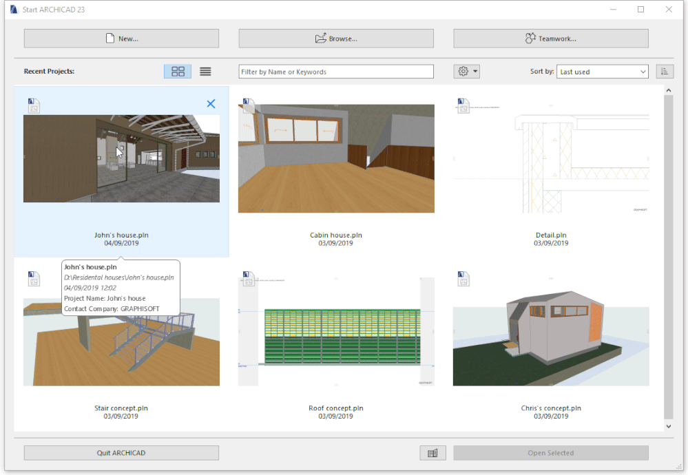

Startup dialog
ARCHICAD 23 comes with a brand new Startup dialog that heavily focuses on recent opened projects. From the dialog you can select multiple projects and open in different ARCHICAD instances. Recent opened projects on the new Startup Dialog can be sorted by Name, Last used, Size and Type, in ascending or descending order using the button
Hovering the mouse over the preview in thumbnail mode will display the last opened tabs of the project. Use X to hide the file from recent opened projects.
The Settings button will allow you to configure how ARCHICAD 23 handles Legacy projects (originating from a previous version of ARCHICAD) and Archive projects.

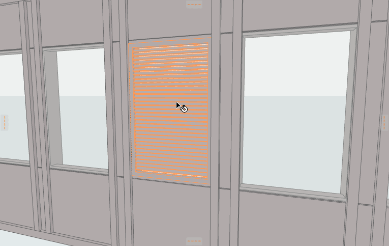

Curtain Wall
The new Louver panel can be rotated in 90 degree increments by dragging the node in Curtain Wall's Edit mode.

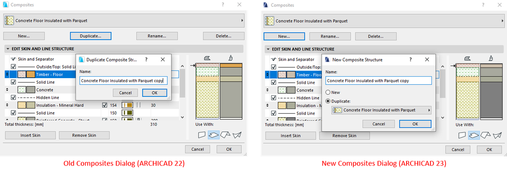

Composites
Duplicate functionality is now merged into New Composite Structure in Composites dialog.

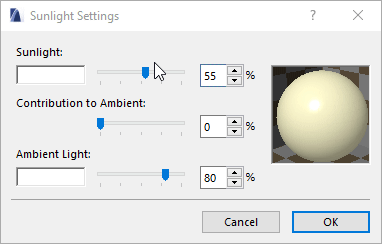

Sunlight Settings
In Sunlight Settings, moving the sliders now provides live feedback within the dialog already before releasing the slider:

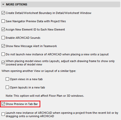

Tab Preview
The new Tab Preview function can be turned off in Work Environment > More Options > Show Preview in Tab Bar
