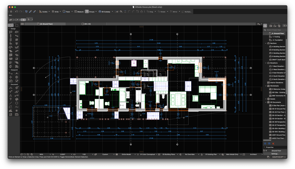

With Dark Mode, macOS users can switch to a dark workspace in Archicad!

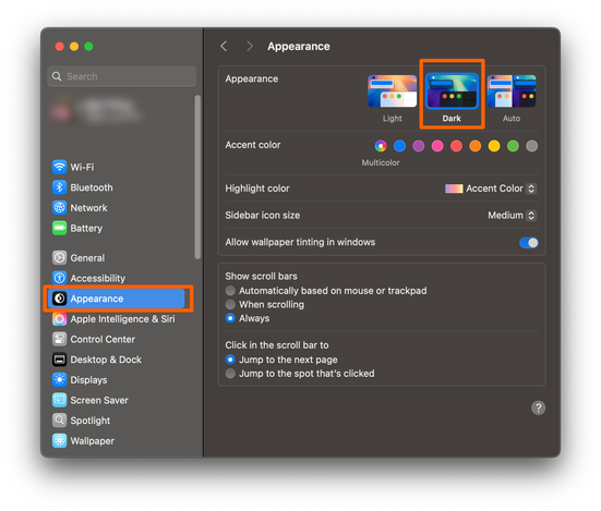

Alternatively, if you set Archicad to Match my device, you can set your macOS to Dark Mode by going to:
  • Apple-Logosu.png> System Settings > Appearance, then select Dark.

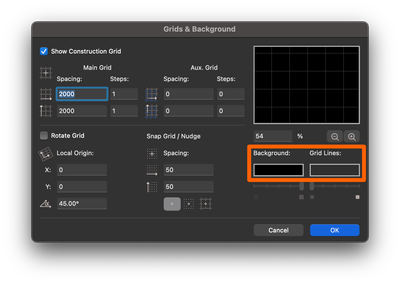

  • Set a Dark Background
    Go to View > Grid & Editing Plane Options > Grids & Background, and choose a dark color for the background. You can also adjust the Grid Lines for better contrast.

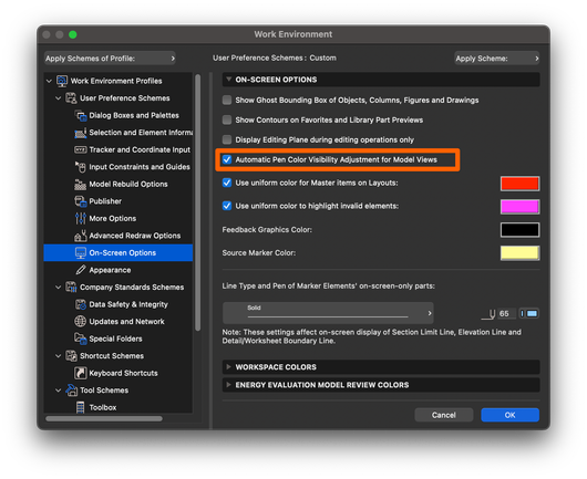

  • Enable Automatic Pen Visibility Adjustment
    Navigate to Options > Work Environment > On-Screen Options, and activate the Automatic Pen Color Visibility Adjustment for Model Views option.

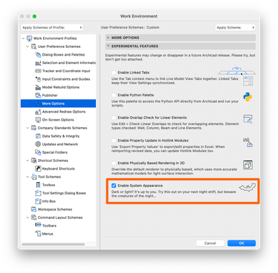

In Archicad versions 24–28, the experimental Dark Mode feature must be enabled under Options > Work Environment > More Options > Experimental Features by activating the Enable System Appearance option.
