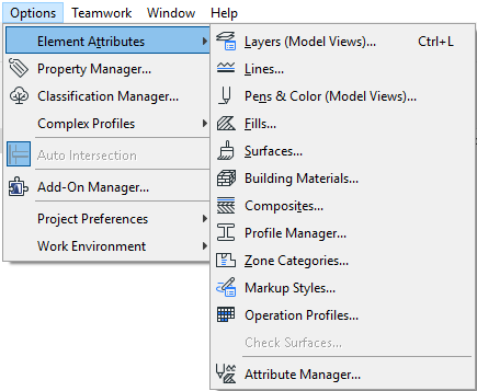

Attributes can be accessed from Options › Element Attributes. Here you can create new attributes, modify and delete the existing ones.
Attributes are stored in the project.

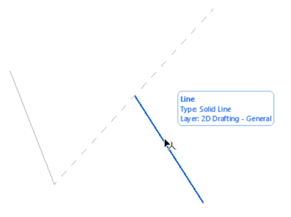

First, select the line or lines you want to change.
The Main area of the Info Box shows the number of selected elements.
By clicking on the drop-down menu in the Line Type area, you can browse in a list of different line types. Select another Line Type in the list.
The change is applied immediately.

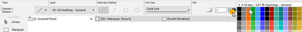

All pens have a color and a pen weight (thickness) assigned.
To change the color of an element you have to change its pen attribute.
To do this, select the line …
… and click on the button Pen in the Info Box.

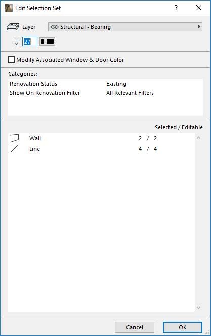

In the Info Box, you can change the attributes of only one type of element.

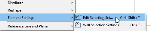

If you want to change one or more attributes of different element types, such as walls and lines, at the same time, open the dialog at Edit › Element Settings › Edit Selection Set...
The appearing Edit Selection Set dialog lists the elements that are selected and editable. In the upper area, you can change their common characteristics (attributes). In this example it is only the pen that both walls and lines have in common and can be modified at once.

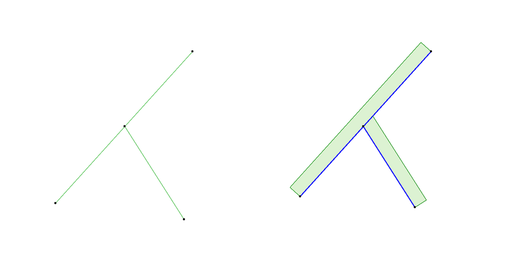

You can change the position of the Reference Line of walls.
Walls with basic structure can have the Reference Line at three different positions:
  • Outside Face
  • Center
  • Inside Face
The button Flip Wall on Reference Line mirrors the wall along the Reference Line.
