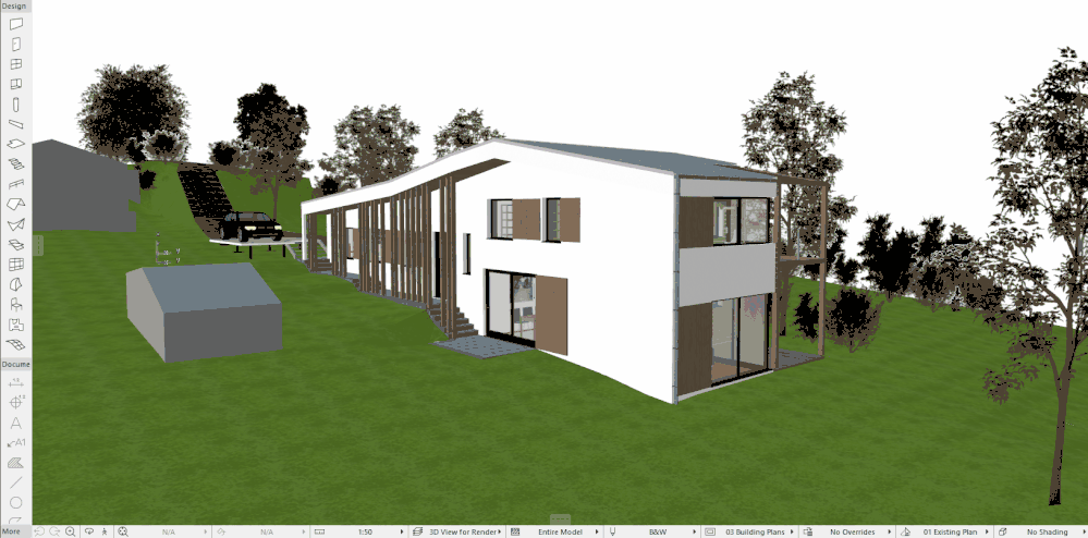

A new 3D navigation mode called Joystick has been introduced in Archicad to make the Explore Model function via remote desktop applications possible and easy to use.
In Perspective views only, you can explore the model either by choosing the View > Explore Model command or access the same command from a 3D toolbar, or from the Quick Options Bar at the bottom of the 3D window.
Now two options (F: Fly, J: Joystick) are available  in the Explore Model mode.

To navigate on a remote machine, use the the mouse moving the joystick on the right hand side and the arrow keys of the keyboard for navigation.
