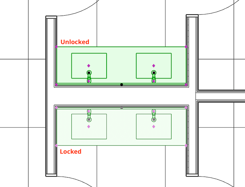

How to Identify Locked Elements
  1. Locked elements cannot be modified (moved, deleted, resized, etc.) in any way.
  2. When selected, a locked elements' hotspots and overall appearance will appear ghosted compared to unlocked element.

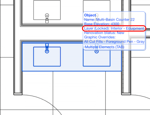

  1. When hovering over an element, the information dialogue will indicate whether the element or the elements' layer is locked.

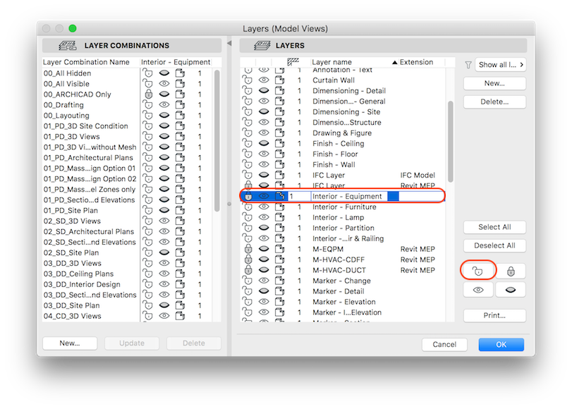

How to Unlock Locked Elements
Layer - Open the Layers dialogue box and click the unlock button.
Individually - Select the locked element and go to Edit > Locking > Unlock.

I appreciate this article BUT IT DOES NOT SAY HOW TO LOCK OR ULOCK and element.
I want to lock an element but not the layer
Karl Ottenstein
Moderator Emeritus
@Eric Milberger It kind of does say how.  Very end of article, "Edit > Locking > Unlock" to unlock a locked element...  "Lock" from that menu ("Edit > Locking") would lock selected elements.
This article was not intended as a substitute for the Help files/manual which give details on both kinds of locking.  It is meant to distinguish between the two kinds 🙂
(For layer locking/unlocking you can also use the context menu when an element is selected without having to find the layer in the layer settings dialog.)
