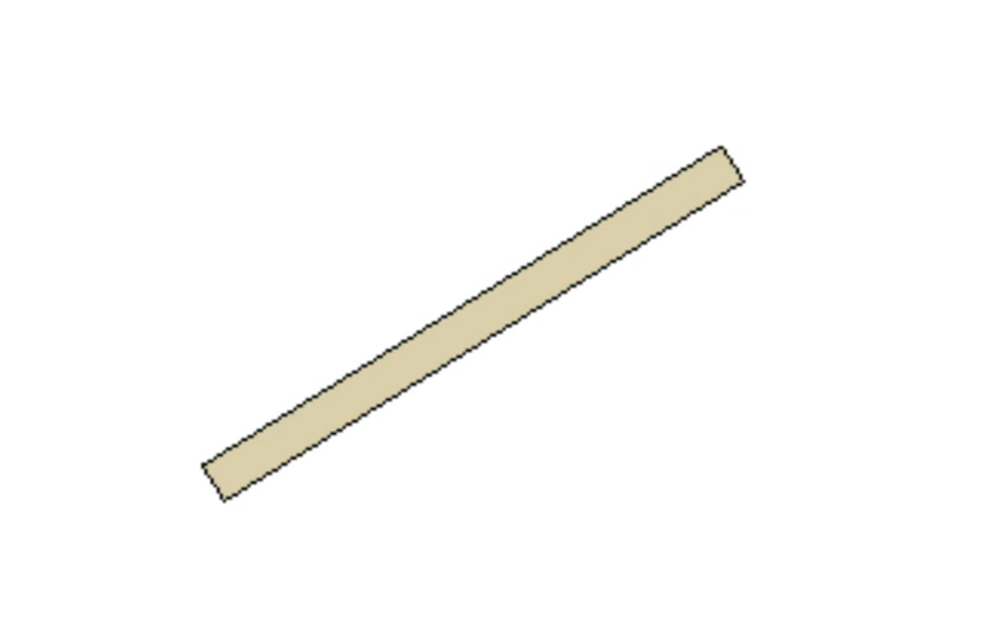

You can also enter the wall thickness which applies to the whole wall length by entering the value in the Info Box.
Note: The wall thickness value is given in the unit that was set in Options › Project Preferences › Working Units as also mentioned in Drafting Basic 2D Elements.

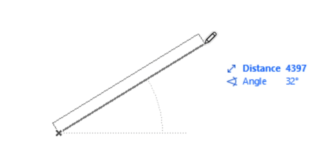

Start drafting a wall the same way as you would draw a line. You can learn how to draw lines from Drafting Basic 2D Elements. Archicad automatically generates the wall based on the line you draw and the thickness you set.

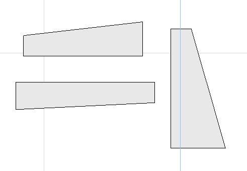

Geometry Method: Trapezoid
The trapezoid (or non-parallel) method allows you to create straight walls, the thickness of which is not constant. This is practical if you model old buildings. You can define the wall thickness by using the “Wall Thickness” fields in the Info Box.
Examples:

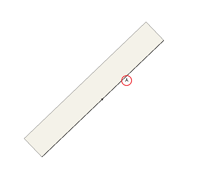

Walls have a special feature, called the Reference Line. You create a wall by drawing its Reference Line. The wall’s contours and 3D body are created based on the Reference Line and the settings of the Wall Tool. (Tool settings will be discussed later in another article.) If the wall's thickness is later changed, the Reference Line stays in place and the contours move accordingly.
During the drawing process (also called input), you can see the thick Reference Line. The thin lines are generated based on the thickness of the wall. When you are done with modeling the wall, the Reference Line is not visible anymore. This is so by default. To make it visible on the floor plan constantly, turn on the Wall & Beam Reference Lines at View > On-Screen View Options > Walls & Beams Reference Lines.
The position of the Reference Line will be visible. The small arrow indicates the direction of the wall.

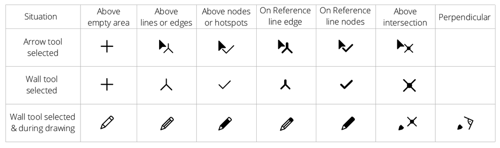

Cursor Shapes
Learn the basics of the Intelligent Cursor of Archicad in The Smart Cursor.

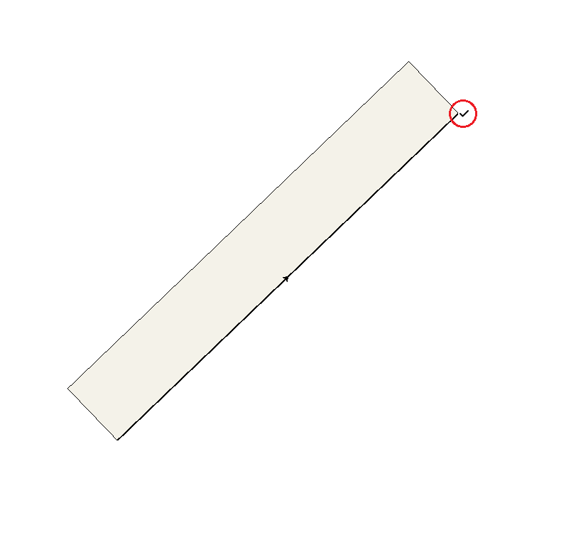

If you slowly move your cursor over the wall, you will see that the cursor becomes bold over the Reference Line.
While you are drawing, you can always check if the cursor is on the Reference Line by looking at the end of the pen…
…it should be black.
Note: To be able to focus on observing the cursor shapes and not get distracted by the blue highlights of snap guides, please turn off Snap Guides and Points. They are turned on by default:
Summary:
