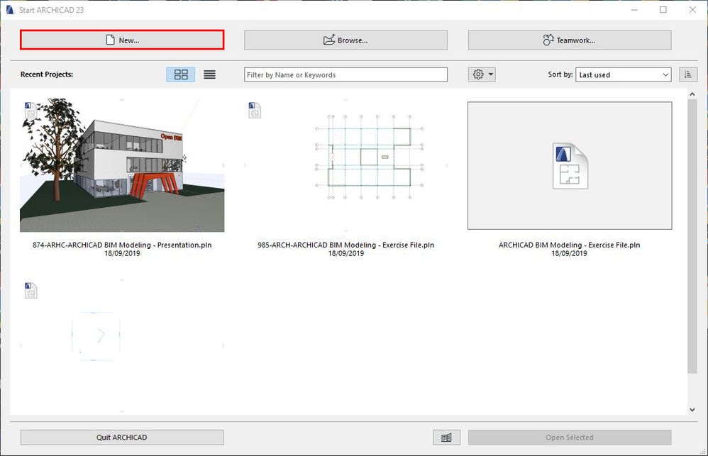

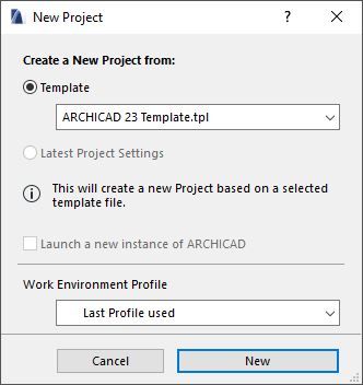

At the start of a project you have to set up a lot of things. Starting your project based on a template file will help you with this. Creating and using your own customized template file increases the efficiency of your daily work. Learn more about this topic here. If your company already has a template file, start the project based on it. If you don't have your own template file yet, start your first project based on the standard Archicad Template that is shipped with every version. Select New in the in the Start Archicad dialog then select the Archicad Template:
If you are not yet familiar with the dialog above or the interface of Archicad, please read this article first. The list below gives you an overview on what settings are stored in the Archicad Template that you can start using immediately and what is not set thus needs to be defined by you.

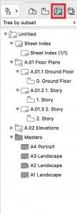

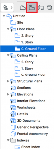

The Structure of the Project - Navigator and Organizer

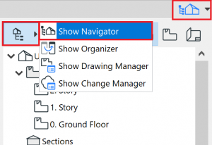

The Navigator and the Organizer are one of the most essential parts of Archicad's user interface. They help you keep your project organized and tidy. By default the Navigator is often turned off. It is recommended to keep it open all the time until you become fully familiar with its functionality.

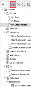

The Navigator is designed to help you go through the entire design and documentation process and to navigate within the project all times. This is a quick guideline how you will use it:
  • You will start working in the Project Map when modeling the virtual building. You can navigate between stories, turn layers on and off, define cutting planes, etc.

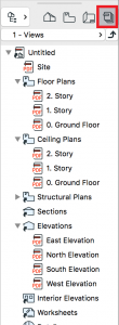

  • As your project evolves, you will migrate to working in the View Map. To prepare internal project checkups and issuance of the documentation, you will save Views and work in the View Map. Views are saved combinations of View Settings that define which project elements are visible and in what way they are displayed in a certain View. You can save many different Views for different purposes of the same virtual building's same 3D content. Custom drafting Views can also be created and deleted whenever needed.
  • The documentation will be prepared in the Layout Book. Here you can create the Layouts on which the saved Views will be placed as Drawings.
  • The publishing of the project as well as the exported files to be sent out to project stakeholders will be organized in Publisher Sets.
Project MapProject Map View MapView Map Layout BookLayout Book Publisher SetsPublisher Sets
