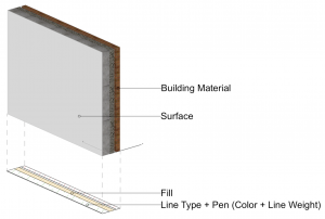

What are Attributes? Attributes hold the most basic characteristics of Archicad elements that define their appearance and behavior when interacting with other elements. Element Attributes can be selected and modified in the Element's Settings Dialog.
wp-content_uploads_2018_12_attributes-1-300x202.png    wp-content_uploads_2018_12_wall-settings-193x300.png
The Archicad Template contains a large number of Attributes, so you can start working with them, no need to spend time on configuring their basic settings. These are the Attributes you will need from the beginning:
These Attributes will be used later in the life of the project: Later you can create your own custom Attributes by either creating new Attributes or modifying the existing ones. The Template also stores default settings for all Tools (3D Design Tools such as the Wall Tool, the Slab Tool, the Window Tool, etc. and 2D Documentation Tools such as the Dimension Tool, the Text Tool, the Label Tool, etc.). Favorites are stored combinations of Tools' default settings that are often used. Some basic Favorites are also provided by the Archicad Template for each Tool. You can easily customize these and create new ones you can best use in your project. Using Favorites helps you speed up the design and modeling process and maintain project coherency.

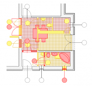

Renovation Statuses and Renovation Filters help you manage stages of renewal projects. With their proper usage you will be able to visualize the stages of the project using the same 3D model.
wp-content_uploads_2018_12_renovation-300x282.png    wp-content_uploads_2018_12_renovation-palette-300x212.png
A Renovation Status is automatically assigned to each element you place: Existing, To Be Demolished or New. Each item you place in your project will have the same Renovation Status by default. At the startup of the project you need to decide which of the statuses will be the default Renovation Status to start with. Check which value is set to be default by the Template you use and change it if needed. The default Renovation Status can be selected on the Renovation Palette and will be  applied to all types of elements and cannot be changed in the Tools' default settings. Once an element is placed, you can change its Renovation Status. As your project develops you might need to change the default Renovation Status. You can do this any time using the Renovation Palette. You can learn more about Renovation in Archicad from the articles under the master article Renovation.
