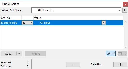

You can select multiple elements at once, which have the same characteristics, also called attributes, parameters, or properties. This functionality is called Find and Select.
You can find the command under the Edit menu.
The following dialog appears:
In this dialog, under the Criteria column, you can browse among a large number of characteristics. Then you can select all the elements that have these characteristics in common.

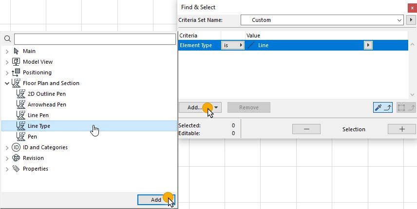

As an example, we want to select all lines with the line type Small Dashed.
Follow the steps below:
  1. Set the value of the first criterion (Element Type) to Line by selecting it in the drop-down list.
  2. Add the criterion Line Type. To do this, click on the button Add. Select Line Type in the pop-up menu by first opening the folder Floor Plan and Section. Double-click its name or click on the second Add button.
  3. Set the line type criterion's value to Small Dashed by selecting it in the drop-down list of line types.
  4. Hit the plus button to select all elements that meet these criteria.

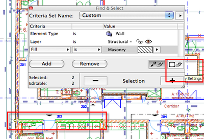

  • Go to the Find & Select dialog box. Edit > Find and Select
  • Specify the frequently used selection criteria (e.g. Fill, Layer, Building Material) and set their values.
  • Another way to set up these criteria is to select an element in your project that fulfills the required criteria, then click the Copy Settings button in the dialog box. The criteria fields will now be filled in with the values of the selected element.

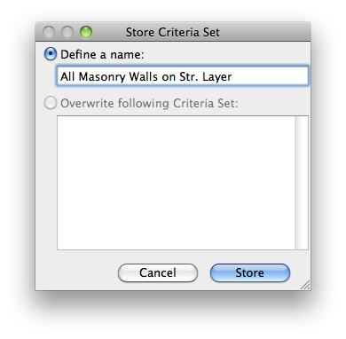

  • Click the right-pointing arrow in the upper right corner of the dialog box and select Store as...
  • Now specify a name for the saved Find & Select criteria. Use a descriptive name a maximum of 31 characters.
  • Click Store to store the Find & Select criterion.

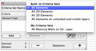

  • Go to the Find & Select dialog box and select your Criteria Set under Your Criteria Sets.
  • Click the Plus button to find & select the elements according to the criteria set.
When needed, use the Rename and Delete commands from the list and perform these operations. Saving and Loading Find & Select criteria sets are possible in any Model View, including the Floor Plan, Section/Elevation Views, or the 3D Window.
