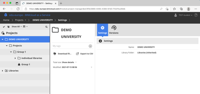

Step 1 - Login to your BIMcloud manager
In your Internet browser enter the server address that you received from us for login.
Enter your username and password. (Check BIMcloud and Teamwork FAQ - for students - Graphisoft Community for more information on usernames and passwords)
Click on Login.
In case you have forgotten your password. Click on "Have you forgotten your password?" You will then be sent a link via email where you can update your password.
Once you have logged in click on Projects to go to your project folder.
Click on the User button if you want to view your user profile or change your password. Please do not change your name or email address.
On the left side is your project area. This includes the libraries folder (Archicad standard libraries) and your group folder.
For organizational reasons, your group folder is located in a tree structure.
- University
- Team folder
- Team project
- Individual libraries

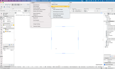

Sharing a teamwork project should be done by one person. To do this, open the Archicad file that you want to share with everyone as a teamwork project in Archicad.
Open teamwork in the Archicad menu bar under > Teamwork > Project > Share...
You now have to connect to the BIMcloud for the EDU server. Enter the server address you received from us when you registered, as well as your login name (Forgot your login? Check it here BIMcloud and Teamwork FAQ) and password for BIMcloud for EDU into the pop-up window.
After you have connected to BIMcloud for EDU, you can share the project.
Select on the left side the folder in which your teamwork project is to be saved.
Click on Share at the bottom right.
Be patient for a moment. Your project is now being shared. For this purpose, all data is uploaded to the server. Depending on how large the project is, the loading time also varies.
After the project has been successfully uploaded, all other teammates can join the teamwork project found in the designated folder in BIMcloud for EDU.
To do this, the other team members simply go to Archicad > in the menu bar click on Teamwork > Open /join teamwork project > teamwork project.

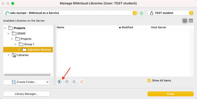

Step 4 - Upload Individual Libraries (optional)
Sometimes the Archicad standard library alone is not enough. With the new BIMcloud for EDU, you can now upload your own libraries and use them for your teamwork project.
Nevertheless, make sure that you do not exceed a data volume of 5GB per team.

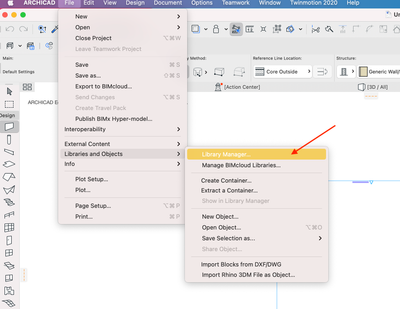

To load a new library on the server, click in Archicad in the menu bar on Files > Libraries and Objects > Library Manager...
In the library manager, you can now see which libraries are already integrated into your teamwork project. By default, these are the default libraries of the most up-to-date Archicad version on BIMcloud for EDU.

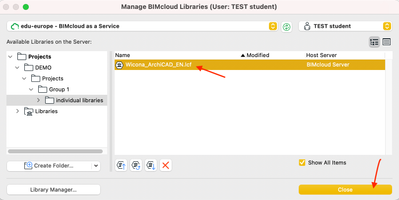

To load an individual library onto the server, do the following:
If necessary, reserve the library manager first.
Click on the button displayed on the right – Manage BIMcloud Libraries.
The window for managing the BIMcloud libraries now opens.
Select the appropriate folder on the left side.
Click on the button on the right – Upload a local library to BIMcloud. (before clicking check that you have selected the correct folder where you would like to upload the library on the left)
You can then select a local library on your computer. Then select the BIMcloud server and click on Upload.
Your local library will then be loaded onto the server. Depending on the size of the library, this can take some time.
The figure on the right shows that the sample library was successfully loaded onto the server.
This window can now be closed.

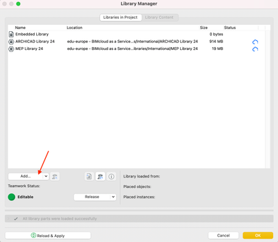

The just uploaded sample library will not be automatically added to the Teamwork project. To add the new library to your Teamwork project you need to follow the next steps.
Still in the Library Manager. Click on the Add button...

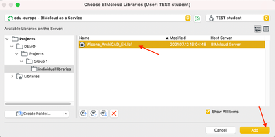

... and select the appropriate library.
Click Reload & Apply to integrate the new library into the Teamwork project. This can take a brief moment.
If necessary, release the library manager via the Release button.
Now your library has been added to the project!

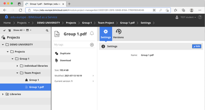

The plan set can now be published directly on the BIMcloud for the EDU server by clicking on Publish.
A window will appear which gives you the up to date information about whether the upload process was successful.
You can now also see the plan set in the BIM Manager, duplicate and download it.
