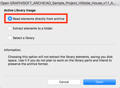

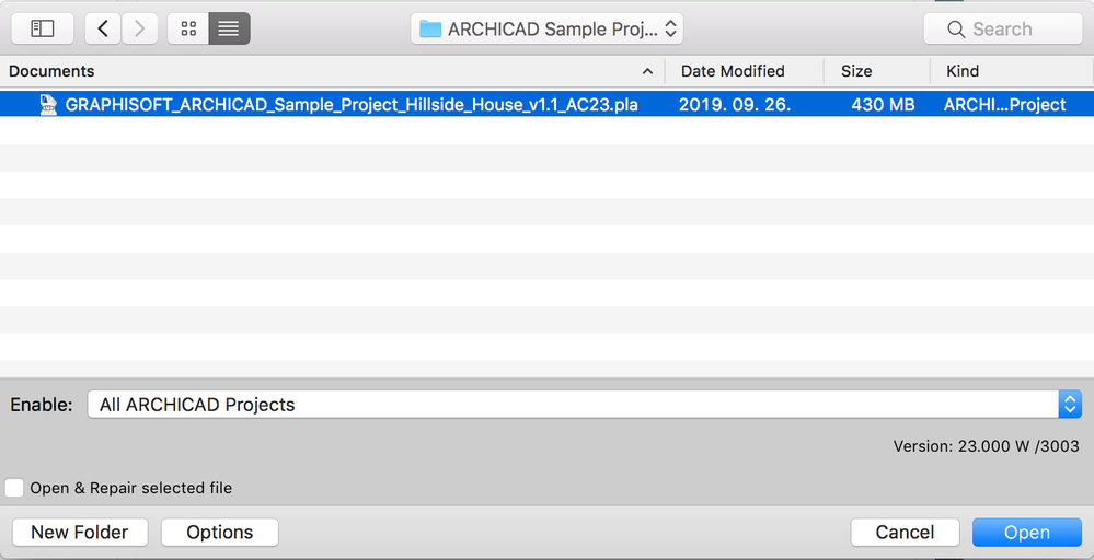

For practice purposes, open an Archicad Sample Project.
Launch Archicad and open the Sample Project by following these steps:

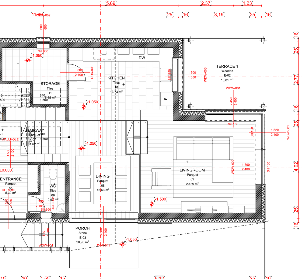

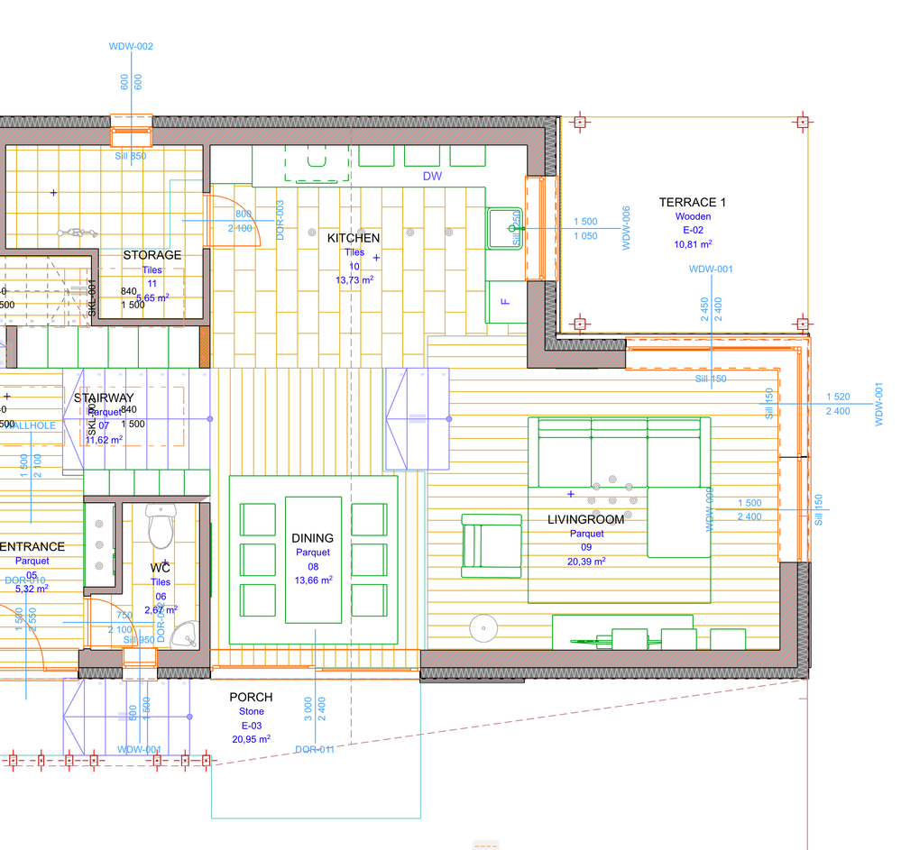

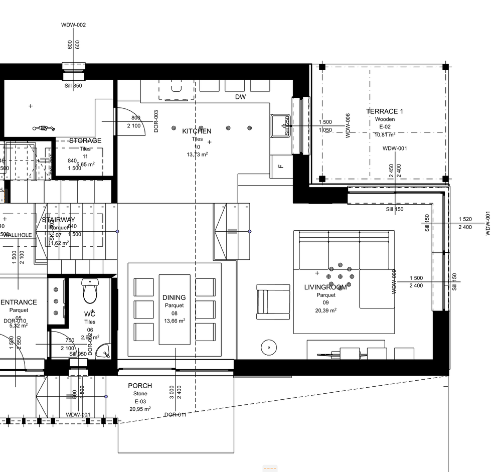

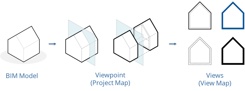

As mentioned in What is BIM? , the digital model (BIM) of the building consists of the digital construction elements and the metadata assigned to the elements. In Archicad, we can view this complex database in many ways. We can view and work on the
We call these viewpoints. The content we see in these viewpoints is derived from the same 3D model. We have the flexibility to define what elements are shown and what elements are hidden, and in what way we want to display the elements that are shown. Once we have set up these, we have defined a view. We can create multiple views of the same viewpoint. In the example below the viewpoint is the plan of the ground floor:
We usually start working in viewpoints, then we go on and define views.
Viewpoints are organized in the Project Map, and views are organized in the View Map. The structure of the project can be best seen in the Navigator.

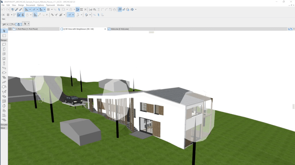

The name of the current view or viewpoint is in bold in Navigator. The content of the selected view or viewpoint is shown in one of the tabs in the main window of Archicad.
In the Archicad workspace, you can have multiple views or viewpoints open at the same time. They are organized by type under tabs. You can show one view or viewpoint of a type at a time under one tab.
You can switch between the tabs on the Tab Bar like in web browsers. You can close them and can re-open them any time by double-clicking the corresponding item in the Navigator.
