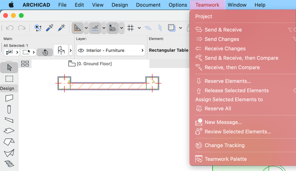

Teamwork is a built-in feature and it can be found on the menu bar whenever you open Archicad. Teamwork allows you to collaborate with other Archicad users on the same project in real-time or on your own schedules, always having access to the most up-to-date model.

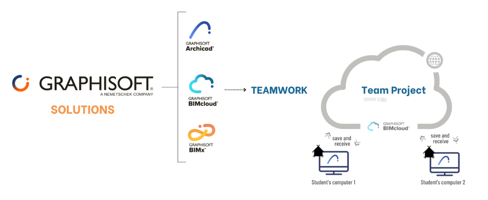

Teamwork runs in connection with BIMcloud. The BIMcloud as a service is a Graphisoft cloud storage product. If you apply for a BIMcloud subscription, you get access to your private space in BIMcloud hosted by Graphisoft. Read more about exact details on How to Start with BIMcloud on our articles listed at the end
 Archicad projects can be shared connecting to BIMcloud. Read more about how you can share projects and how to upload or find BIMcloud Libraries. Once your project has finished uploading to the cloud, your team members can join in to start the work.
Those who joined a teamwork project will always work on their local copy of the shared project and from time to time, through the "Send & Receive Changes" command, the local copy of the design project is synchronized with the Teamwork project on the server.
It enables users to work in remote locations without an Internet connection or while online.

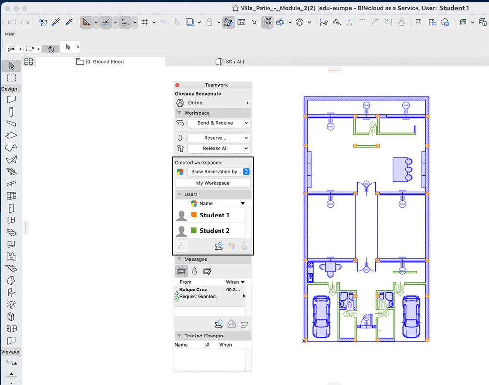

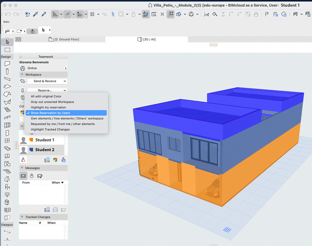

Team members can reserve parts of the project or work on individual floors, sections, elevations, or layouts. Automatic, real-time element reservation helps everyday work by supplying exclusive access to specific design elements without hassle.

In Teamwork, that is possible because you can reserve all the elements you are working on in a story. That way you can guarantee that no other member will change it or remove it by mistake, unless you release the elements.

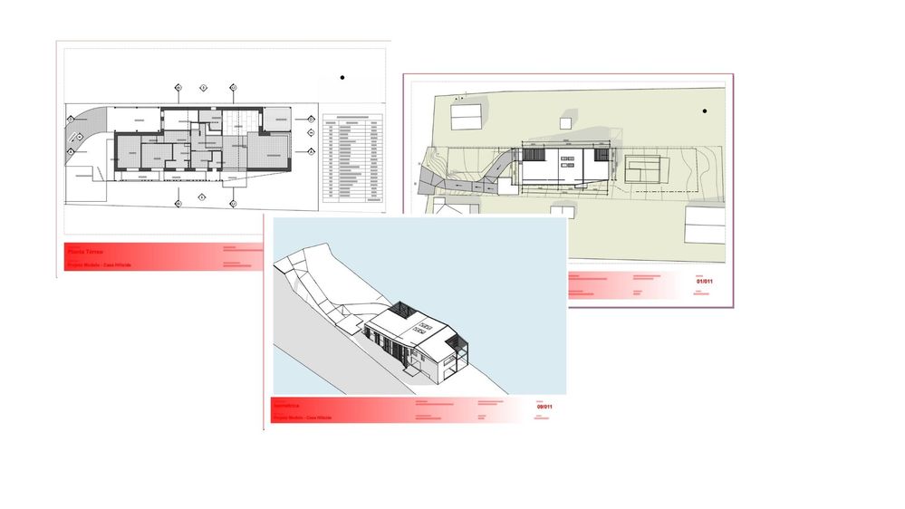

  • Separating tasks by deliverables
In case your group members are dealing with different phases of the project, such as drafting, modeling, documenting, and rendering, teamwork keeps all modifications in one file.
Now, you don’t have to publish a new file to your team members every time you update the file, or even struggle with getting access to a file that only one unreachable group member has. Instead of waiting hours or days for your friend to send you the correct project file, you can always access your project file in teamwork and these setbacks’ pains are lessened because everybody that is part of the shared project will be updated with any changes every time they click “RECEIVE CHANGES”.
The members have more autonomy to get all the information/files/views by themselves. A group member could be assigned to create the layouts with the final drawing, another could be taking care of creating diagrams by filtering layers and setting the graphic overrides of a view, and another doing schedules of elements or surfaces of the project, everything happening simultaneously.
