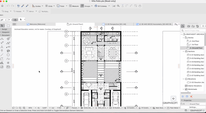

Step 1: Switch to a model view
Leave the Schedule View and navigate to a 2D Viewpoint (like the Floor Plan or a Section).

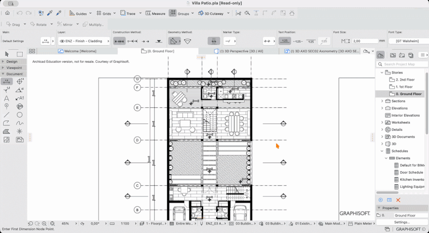

Step 2: Set New Dimension Defaults
Deselect all elements (press Esc). Activate the Dimension Tool from the Toolbox and open its settings dialog (Ctrl/Cmd + T). Adjust the pens, text size, marker style, and other options until they match your desired schedule appearance, then click OK.

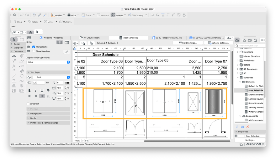

With just a few clicks, every preview in your schedule updates to the correct pens, text styles, and markers, giving you clean, consistent graphics across all door and window elevations—without repetitive manual editing.
