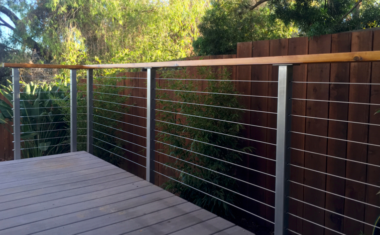

Railing A: horizontal cable runs
Source: https://br.pinterest.com/pin/20125529567974053/

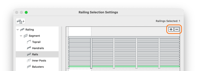

In the International template, you may start with the Favorite “Wired Railing”. Using the symbols ‘+’ and ‘-’, add or remove elements as necessary:

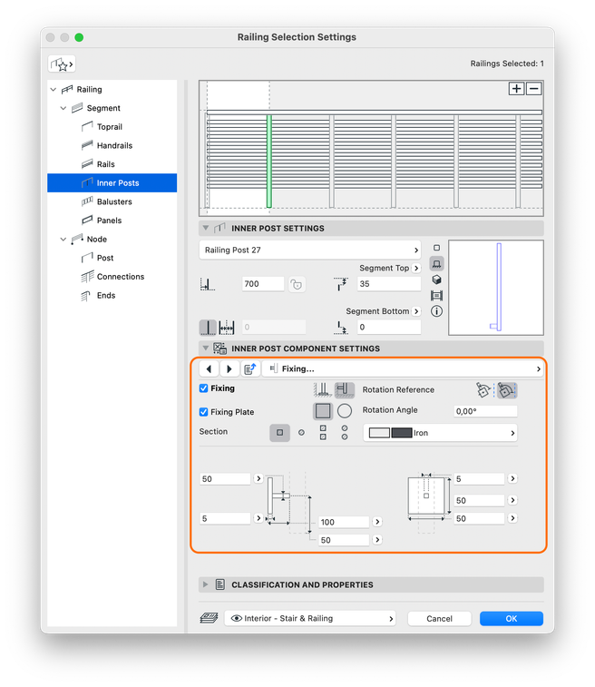

Likewise, set Inner Posts for intermediate spacing – dimensions, profile, material, etc. If you toggle on the Equally Distribute Pattern (max. length) option in the Segment settings, then you can set the optimal spacing of the intermediate posts:

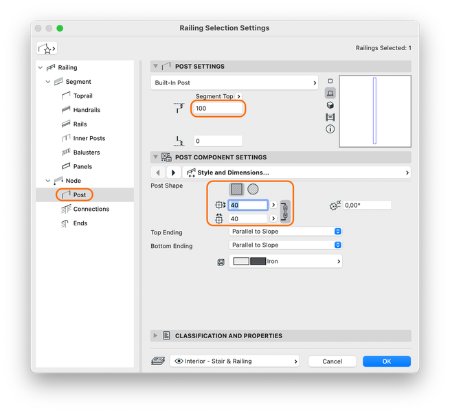

Set the end posts for corners. You can also set Ends settings to control how far past the last post the Toprail will project.

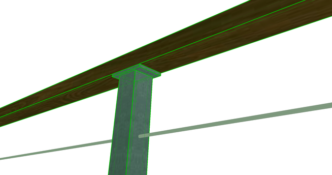

Adjust the fixing of the Toprail:

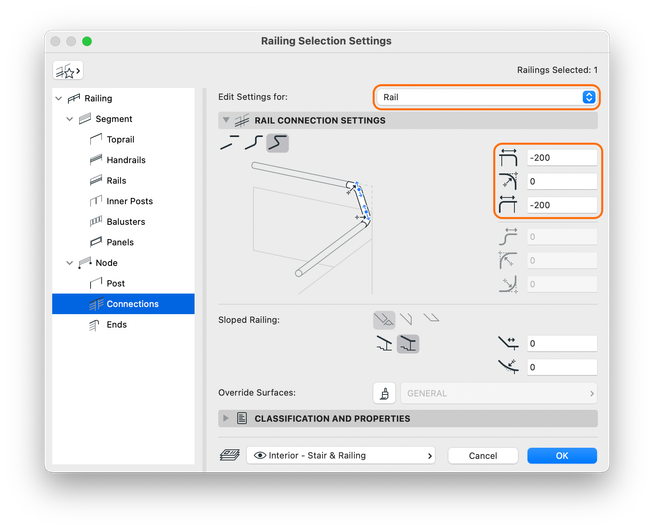

To achieve a realistic detail in the corners, set up Connections for the rails:

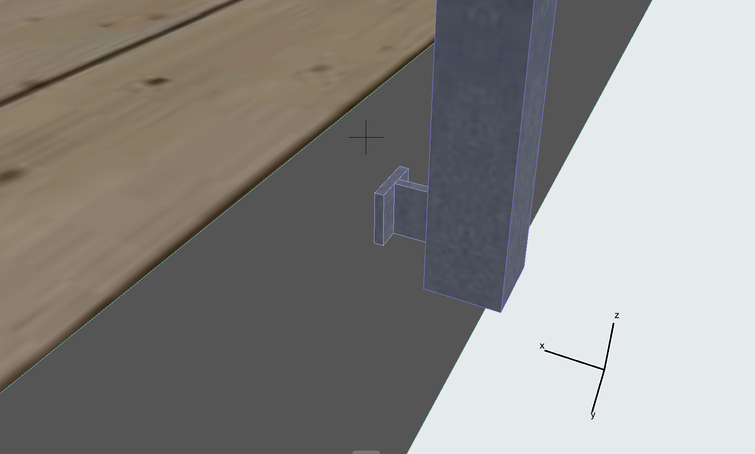

Finally, adjust the position and height of the whole railing and fixing solution at the bottom:

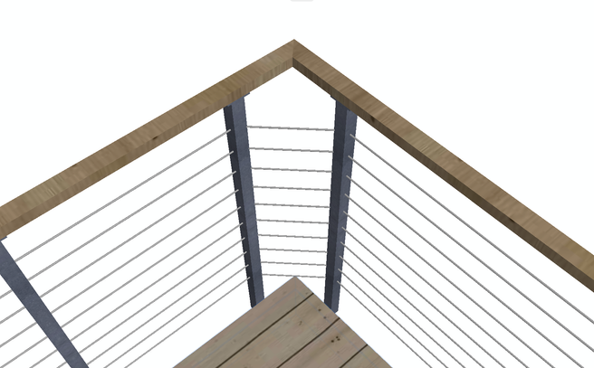

Result:

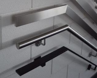

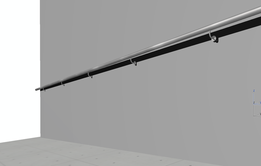

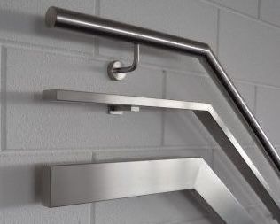

Railing B: wall mounted handrail with brackets
Source: https://br.pinterest.com/pin/1618549861730713/ .
For such cases, we will simply use a Handrail with wall fixing:
The fixing distribution settings can be customized in a dedicated tab. In this case, our Railing does not contain any posts, therefore we should use either the distribution by number of divisions or by pattern (pre-defined distance).
Result:
