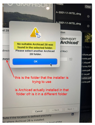

It seems to me that you could download the installation file OK - the original poster could not even do this.
You must have been able to as you are running the installer.
It is trying to find Archicad in a default installation folder path.
It seems to me that maybe your Archicad is installed somewhere else - not in the default folder?
Check that you are installing the update to where Archicad is actually installed.
