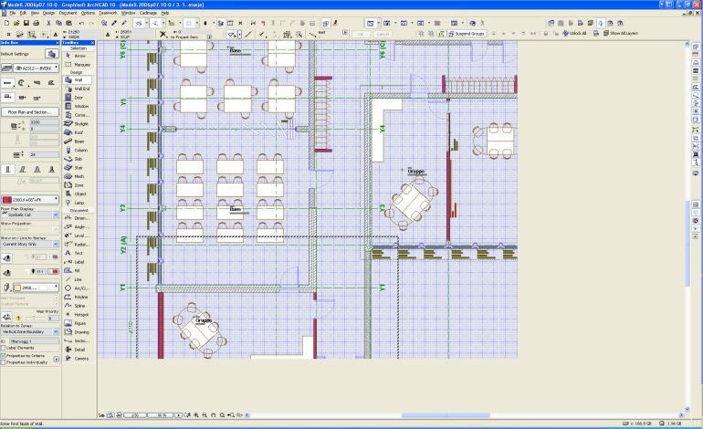

After closing the 3D window, the 2D window (Floor plan) sometimes will only update the parts of the screen which were covered by the 3D window.
DESCRIPTION
After closing the 3D window, the 2D window will sometimes only update the parts of the screen which were covered by the 3D window. This only happens when the Floor plan window is maximized and 3D window isn’t. (When 3D windows is maximized it will cover the whole 2D Floor plan and the whole Floor plan will update)
Screen shot. 2/3 of Floor plan is missing.
