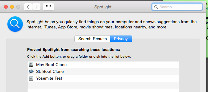

Be sure to avoid 'clone wars' in Spotlight and Time Machine by setting each to ignore the (other) clone volumes. Otherwise, you'll see multiple copies of each app/file in Spotlight/Finder Find and won't quickly know which one is part of the system you've booted to.
Thanks Karl, I wasn't sure if this was possible Sorry, can't help on the AC17 issue.
