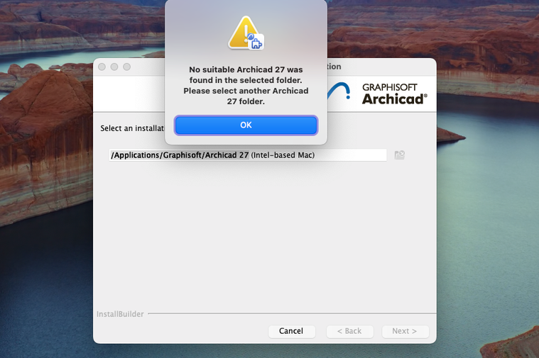

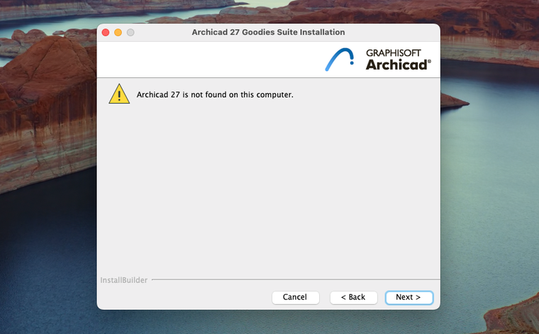

trying to load up some goodies as i would like to try the slab accessories. however, this is the problem?

Check you have the correct goodies installer for your Mac Archicad installer,  Apple Silicone vs Intel-based Mac.
https://graphisoft.com/us/downloads/goodies
Scott J. Moore | Fulton Trotter Architects | BIM Manager, Associate, Architect
Since AC13 | Current versions AC23.7000 & AC26.5002 | BIMCloud Basic | Python, GDL, VBA, PHP, SQL, CSS
Certified Graphisoft BIM Manger (2022)
Win 10, i9-9900K, 32GB, Quadro P2200, 500GB NVMe
Do you have the correct language version for the goodies download - INT, USA, UKI, etc. ?
Do you have the correct MAC OS version - Silicon, Intel ?
Is Archicad installed in a non default location ?
I am guessing you have the Intel download but need the Silicon one.

based on the "about" windo i thought it was mac based but will try the intel since the screen shot prior shows the intel which is where i probably didn't notice until this morning
