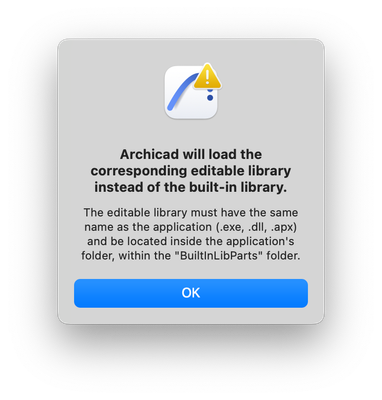

Error message every time I launch Archicad
claudiuiancic
Every time I launch Archicad (from the dock icon or by opening an existing pln file), the launch process is interrupted by this window (see attached screenshot). I can only hit OK since it's the only option but I would like to fix the problem and not get the window anymore.
Where is the location where I should have this "BuiltInLibParts" folder?
I uninstalled and reinstalled AC but the error message still appears.
Please help. Thanks.

I just found this great article and my problem is solved now. 👍
https://community.graphisoft.com/t5/Installation-update/Preferences-Cleaning/ta-p/303676
Thank you all!

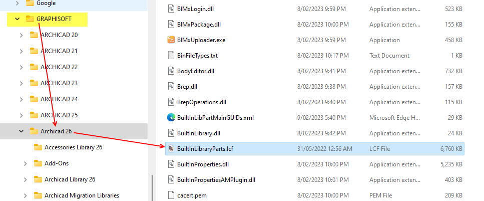

The 'BuiltInLibraryParts.lcf' file should be in the default program folder.
This is from a Windows machine, but should be similar on a MAC.
Did you instal to the default location?
Is the file there?

That certainly looks correct.
I am not a MAC user, so I am not sure what you would need to look at next.
But I would contact your local Archicad support if you have a support agreement (or subscription).
