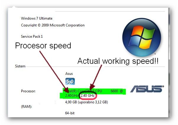

Tom,
Teamwork has nothing wit this. The PC is SLOW because the current procesor speed is only 1.00 GHz!!. Must be at 2.66 GHz.
Check your PC´s BIOS settings.
hmm, wordered what that means.
I may ruin the computer if I screw around with the BIOS settings.
Might look into it though, thanks.
Try to check processor´s speed after you turn on the computer:
Control panel > System and Security > System
If it is on 1.00 GHz, then this is set in the BIOS. To go to the BIOS, when turning on the computer press "Del" key (first key left of the Enter key on the numeric keypad). Or may be some other key (check the users manual of the computer). Under the menu Main you will find System Information > Processor. If it is on 1.00 GHz, you go to the menu Advanced > CPU Frequency (now select 2.66 GHz). Save changes and Exit. Reboot the computer and when in Windows recheck the speed.
