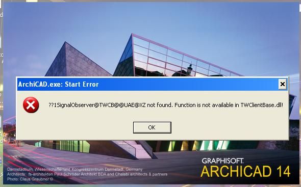

After installing HOTFIX 5 - 4044, my Archicad 14 doesn't start in my Windows XP pc.
This is what i see.
Help me!!!

Nicola,
based on the screenshot something went wrong when patching TWClientBase.dll. Try to disable your Anti-Virus solution (the best is disconnecting all network connections for the period), that might block the installer. Then insert ArchiCAD DVD and run the installation, it will find your current ArchiCAD instance so will run in repair mode. After it will be repaired apply the hotfix again.
Let us know the result,
Marton

Everthing is OK.
But why do you not make a possibility to repair only the last hotfix installed (not the double passage repair Archicad and reinstall Hotfix)?

Nicola,
I am glad that AC works now.
In such cases it is important to make sure that all files are ok, with a full repair install this can be done.
