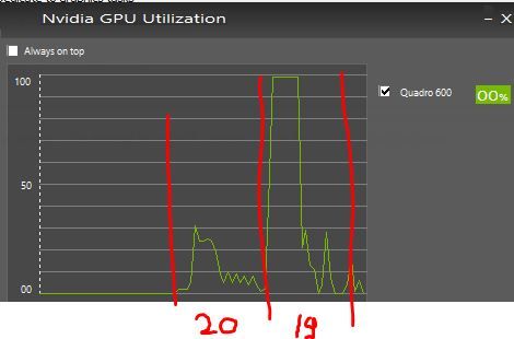

I am having the same problems. Just loaded up Archicad 20 today for the first time and 3d is barely usable. Loading time did not seem to be an issue but I have the same exact file opened in Archicad 19 and Archicad 20 and the difference is significant when moving around in 3d space.
Attached is the GPU usage charts from both programs just rotating around in 3d its seems that Archicad 20 is not fully utilizing my GPU. Not sure if this is the issue or if this is a result of something else that is causing the problem.
I will run additional tests on the other office machines when time allows. As it stands now, I cannot migrate my projects to AC 20 with this drop in performance.
Ok I just figured out the issue.
I was using the PotoRenderings Setting Background Image setting. Using an Image in AC20 drastically reduces performance. As soon as i switched the image off, performance came back to normal. This is not the case in AC19
Graphic Card is able to use 100% GPU also.
I can work without the Background Image but it would be great if we could fix this. Another option would be to have gradients for the background color instead of solid colors. Sketchup for examples uses very nice gradients for their 3d visualization.
I send snapshots of the 3d window all the time to clients, gcs etc. Therefore i need the view to be as appealing as possible. This is not used for presentation drawings but for the day to day communication.
