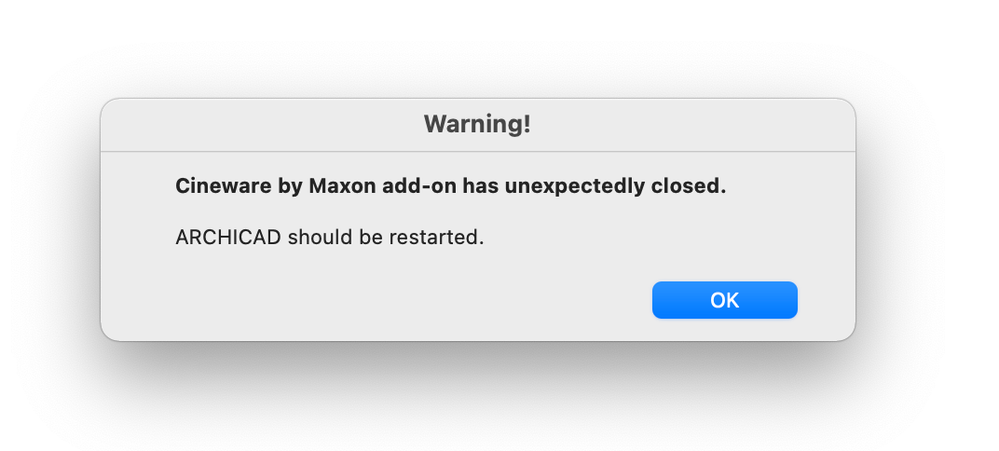

After a few weeks of work I am finding some items that do not seem to work properly. I have now upgraded macOS to 12.1 and also done a Repair with the Archicad 4013 installation just to ensure that all is well from an install perspective.
What is not working are renderings. While both Maxon and Redshift can be called up, neither renderer is currently completing renderings for me. They start and then stall out. Sometimes I get a message that Maxon quit unexpectedly and that I need to restart Archicad.

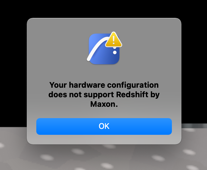

When switching between Maxon Standard and Redshift, I also at times get a message that my hardware is not compatible. Before macOS 12.1 (on 12.0.1) I would get this message every time I try to call up Redshift.
