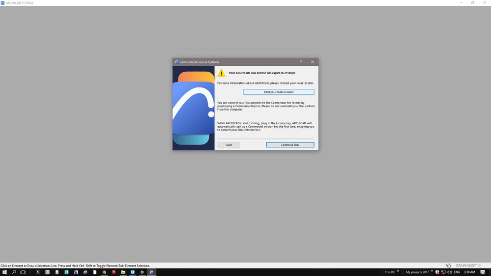

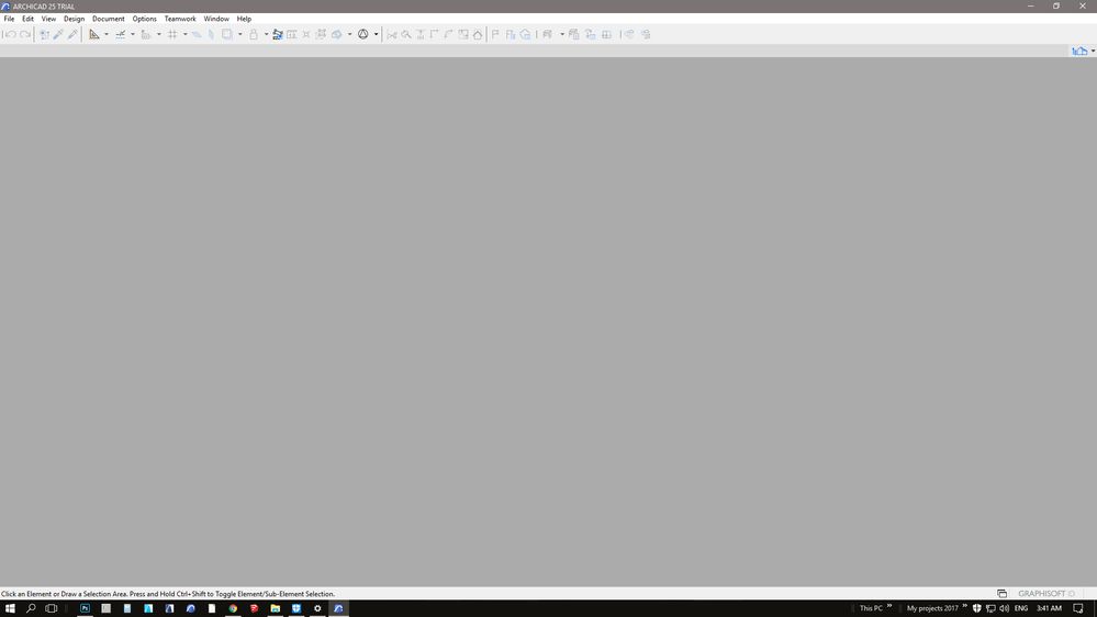

Hi, Archicad community. I have installed the new AC-25, and there is no the startup dialogue with recent and autosave files, as it was in previous versions. The Archicad immediately opens with the blank interface. What is the reason, and how can I restore it?  Who can help me?

Recently, we found a culprit in one of the reports on Archicad 24. Here is the suggestion from the developers:
- Navigate to the %LocalAppData%\GRAPHISOFT folder
- Check whether there is a CEF.cache folder in there (this folder's name can be translated depending on the region)
a/ If only a file is presented with the same name, delete it
b/ If the folder is not present, create it
- Launch the Archicad via the Starter and see if the Start Up dialog appears.
Looking forward to hearing from you!

Perfect Minh.
That was exactly what was needed.
I deleted what was in that folder and 23,24 & 25 all start with the start dialogue now.
Thanks very much.
So on a Windows system ... C:\Users\your_user_name\AppData\Local\Graphisoft\CEF.cache
Note the AppData folder is a hidden system folder, so you will have to show hidden system files in your settings.
levonarsh
Thank you all for all your response. I didn't wait for this solution and have fixed the problem not in the best way, but I have done it by creating a new Windows user account. Now the startup dialogue exists.
It worked! But I had to do it like you said, deleting all the files inside that folder, not only the cache file like the original solution posted.
Anyways, Im super glad it works because I needed to recover a file and was getting desperate. Never had this issue before.
