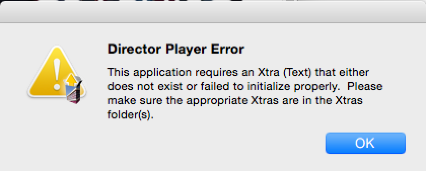

Archicad 19 Director Player Error
I wanted to install Archicad 19 Edu version on my Mac (Yosemite 10.10.5) but I got this error and I cant find anything about how to fix it. The installation wont even start. It just says whats on the picture...

Katalin Borszeki
Dear fliky,
This might be happening due to various reasons (maybe the frontend got corrupted during download, or you lack some permissions). You can start the installation manually. Just open the DMG, open the ArchiCAD 19 folder, and you can find the installer app there. Just click on it twice, and hopefully the installation will start. Best Regards,
Katalin Borszeki
Implementation Specialist
GRAPHISOFT
http://helpcenter.graphisoft.com - the ArchiCAD knowledge base
Rob
It seems that your Adobe Director is taking over AC Installer.
You can bypass this by scrolling down in the installer window (as per your screenshot). You will see additional folders, click on one that is called Archicad19 - open this folder and run installer file from there.
