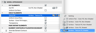

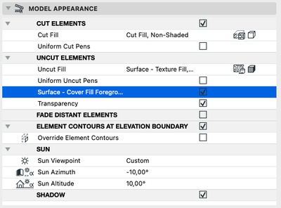

We are using surfaces in our fasades. When we turn of surfaces it works fine.
Reinhold Klein
MacBook Pro, 16. M4 Max, 48GB, Apple Studio Display, MacOS 15 Sequoia
This one is the problem.
