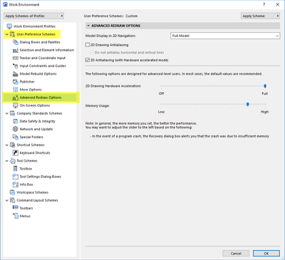

Does playing with any of these settings in your Work Environment help?
These are my current settings.
But my machine is nowhere near your specs and only Windows 10.
