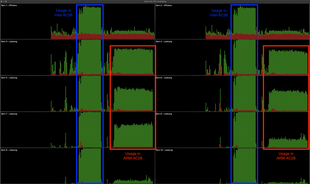

When checking my system usage while rendering (see the attached image) I noticed that Intel-AC26 uses every single available core to its full potential whereas ARM-AC26 uses only 5 cores to about 70% and a sixth for maybe 25%.
I strongly doubt this is intentional and think that there are still performance gains to be made if the current ARM release only uses half the available cores and of those used cores, none are even utilised fully.
ARM-AC26 also doesn't seem to use more than those 5 cores for any other task, though, due to limited testing (I got my hands on it just an hour ago), I cannot confidently say so.

Thermal throttling wasn't an issue: temps under Intel didn't go above 83°C, and ARM didn't go above 70°C.

Tamas Gaspar
Hi mrecinar,
In the last couple of days, we received reports about the rendering slowness with Apple Silicon version of Archicad 26. With the help of the development, we are currently investigating the reason of it with high priority. I'll keep you updated about this matter when we know more about it.
As the rendering slowness doesn't happen in the Intel based version of Archicad 26 (not even on Apple Silicon computers), as a workaround, I suggest using that Archicad for rendering.

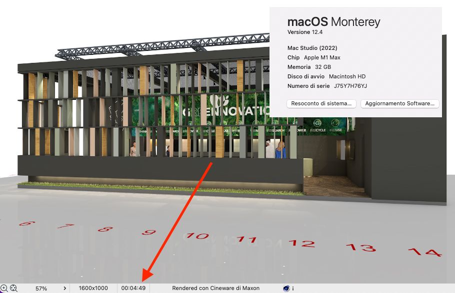

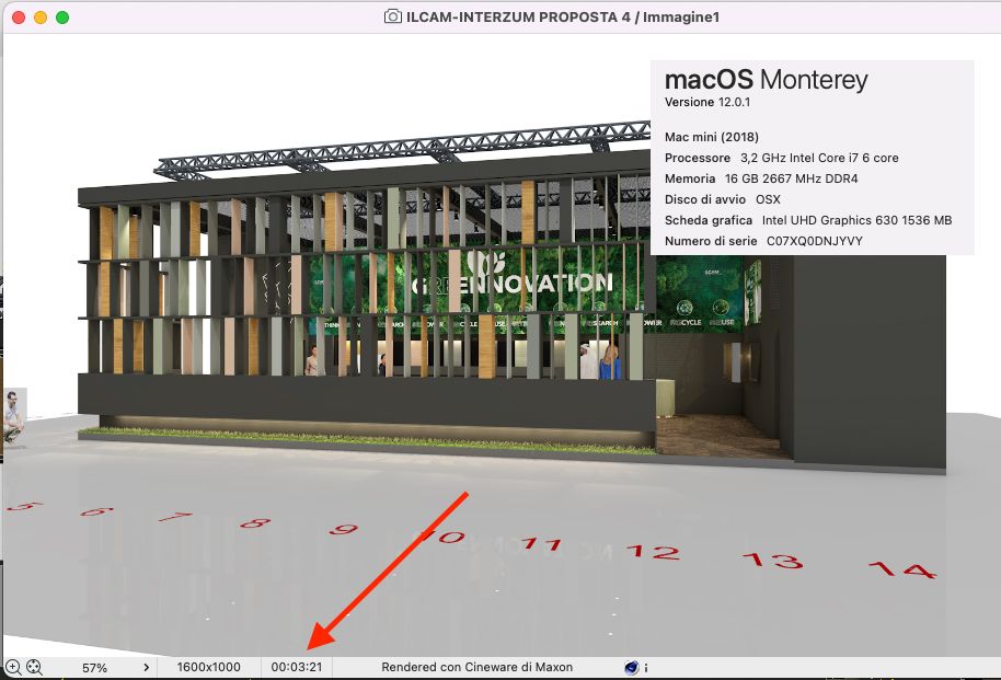

I don't believe it. The render is faster with Mac mini intel ..............
velocità render ARCHICAD 26 CON M1 MAX .jpgvelocità render archicad 26 intel.jpg
Are you using the silicon version of AC 26 on the M1 Max machine?
