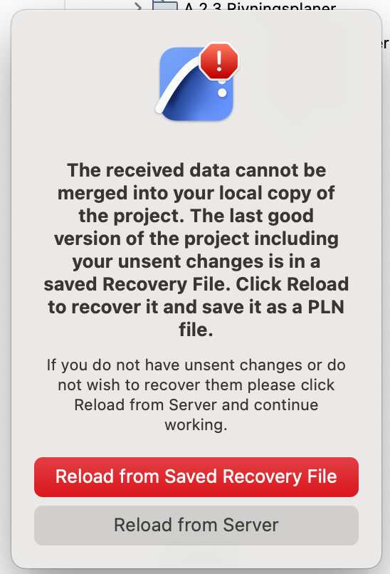

I'm having constant problems with Archicad 26.
Does not matter if I work in a teamwork file och solo.
Solo files have to be repaired once or twice a week, sometimes more.
We have had two major problems with TW-files in the last month.
One of them had to be sent to Hungary for reparation  by the developers.
And now today I got the attached error message when i click receive. And I haven't had the force to solve this yet.
Im trying to figure out if we have a serious IT-problem or if this is an unreliable version of Archicad.
How does Archicad 26 works for the rest of you?

We haven’t had many issues with 26 both solo projects and Teamwork. How’s your BIMcloud server configured? Could it be an interruption to your network.

Are you opening Solo files directly from your machine or are they located on a cloud based server or local based data storage?

We have issues with file crashing when working with "Publisher tool" in AC26 😞

Our problems are coming from this issue as well...
I've been told that a solution is coming with the next update.
I really hope so, beacuse as it is now, Im constantly worried our files will crash and I'll have to spend 30 minutes fixing them...
AC 26, OS MONTEREY
We found what causes crashes in AC26 you can find more information in this tread, so you don't need to afraid that file will get corrupted again.
