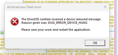

Archicad 28 is constantly freezing or crashing, diving a Direct3D / graphics card error.
Archicad 27 and Archicad 26 do not have the same problem.
I've updated graphics drivers, and uninstalled / reinstalled Archicad to no avail.
I get the same error every time; sometimes, it's within seconds of opening the program. Other times, it can take several minutes. But it happens multiple times a day.
'Direct3D Runtime received a Device Removed Message DXGI_ERROR_DEVICE_HUNG'
That's typically an issue with either the graphics card itself or the graphics card's connection the rest of the machine. However, this is the *only* program experiencing the problem, which is usually indicative of a glitch in the program or an incompatibility between the program and the graphics drivers.
These are two of the smallest projects I've ever done in Archicad, and the only two on 28 so far. Archicad 28 appears to be sending conflicting instructions to the GPU, which causes it to hang. No other programs are effected when it happens; in some instances, when it happens in one Archicad 28 file, it doesn't even impact the *other* Archicad 28 file I've got open.
Dell XPS 15 9530 with NVIDIA GeForce RTX 4060 Laptop GPU.
Archicad 28.0.2 (3110)

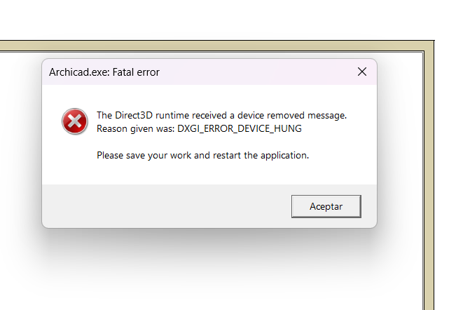

Hello everyone,
I am experiencing a serious issue with Archicad 28. The program runs normally for about 2 minutes, but then the following error appears and the application freezes (stops responding), becoming unusable:
“The Direct3D runtime received a device removed message. Reason given was: DXGI_ERROR_DEVICE_HUNG”
My system specs are:
This happens consistently, making it impossible for me to work.
I have already tried lowering the graphical settings within the software and also updating my graphics card drivers, but the error still occurs.
Has anyone experienced this issue or knows how to fix it?
Any help or suggestions would be greatly appreciated.
Thank you in advance.
Moderator edit.
This post merged with similar topic
Saturday
There has been an ongoing issue with sloppy nVidia drivers, but I cannot remember anybody reporting similar issues with AMD.
Are you by any chance on a laptop? If so you can try to disable the internal GPU. One common error is that Windows wants to "smartly" manage energy consumption by switching graphics on the fly. Your description on that it works for the first minutes is remarkably close to that. The switch then goes wrong and Archicad is left with no device to speak to.
