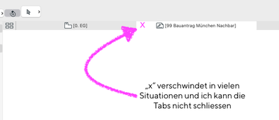

Do you mean close buttons in Tabs? If so, mine is also presenting a problem. The function close tab (with "x" on the corner of every tab) goes missing after closing one tab and other situations. So I cannot close the tabs. That in AC29, Mac, Tahoe.
Grüße
Jaki
No, that was an issue relating to the dark mode in Windows operating System.
Yours seems to be an issue with Tahoe?
Do other users on the same OS have the same issue?
I would also make a call to your local support to see what they say.
