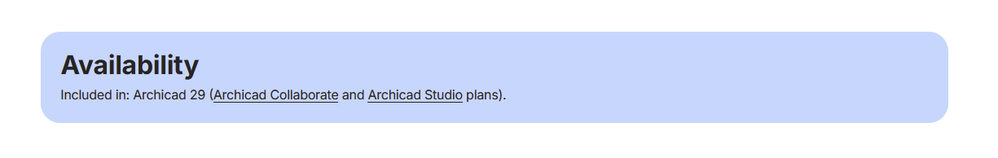

I have a Hungarian Archicad licence and have downloaded Archicad 29. However, when I open the programme and try to use the AI Visualizer, it does not work. Operating system used: Windows.
According to the information on the Graphisoft website, the AI Visualizer is integrated into Archicad 29. Could you please let me know why the AI Visualizer might not be working with my licence?
Is there any additional activation, subscription, or licence requirement needed to use this feature?
I would appreciate your help in resolving this issue.
Thursday
As per the Graphisoft website, it is only available if you have a current collaboration or studio subscription.
